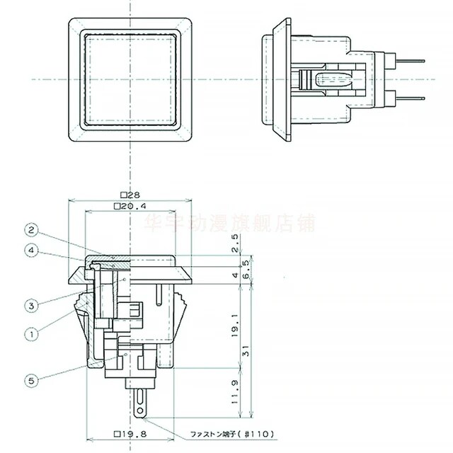

I'm trying to make a control panel that fits two rows of sanwa OBSF-24KK buttons. These are the general dimensions.
I haven't decided on the material of the control panel since it'll be for a handheld controller and not a cab. Most likely plastic/acryllic
The only thing that gives me pause is that I've never tried to drill a hole for a square button before. Anyone have tips? This doesn't look like something I can do with a hand drill. I'm pretty inexperienced with fabrication in general so any help is appreciated.
If acrylic have someone laser cut the holes? Design the layout in CAD and create a DXF file, pass that on to a fab shop and they should be able to make it for you.
