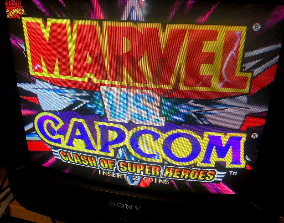

oooh sounds like a winner... let me try right now Thanks Frank
So the battery definitely needs to be removed. Otherwise it will hold the last loaded game's key, and when a new game is loaded the corresponding new key won't be able to be loaded.
Well spotted. :thumbsup:
Now we know the board works with a darksoft kit i got to cough up some coin
