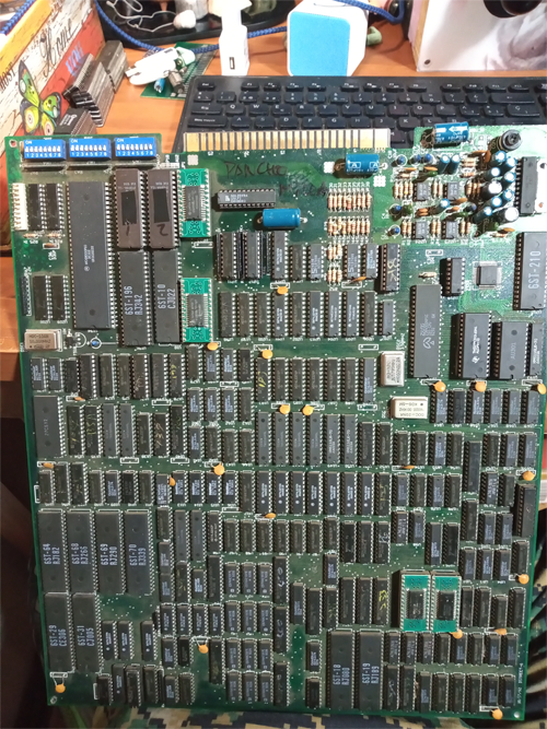

I had a lot of this bootleg SF2CE boards. there are very common in my country and i bet its spreadly common in latin america.
As i saw here, your are more familiar with MSTREET6.
DSTREET6 is identical to MSTREET6 with phisically small but useful big differences:
DSTREET6 have two extra 27c010 eeproms near the program zone. and a GAL20V8.
The data on eeproms contains nothing more than everything needded to patch the main program.
since all diffrerent code is together in each extra rom, is gal20V8 that arranges this chunks of code and override over the normal data of SFCE, so, the cpu runs.... a hacked game.
Chinese bootleggers made a "upgradeable" SF2CE bootleg board.
i saw my ancesters improving this boards by changin this two eeproms. the upgrade was SF2CE-M7 into SF2CE-KOURYU
(yea, i worked on arcade labs since 12 years, cleaning bezels, changing buttons etc)
this place is always to put something data that alters the game.
there is a bunch of this bootleg cards here, hacks are funny but sometimes people wants to have SF2CE as is (slow, but without stupid hacks).
so, i decide to make a pair of eeproms with the data of an original SF2CE.
Thata was easy. i just identify every group of data to be overriden, and i copy the same chunk on original rom and replace in eeprom, so, the result, is a pair of eeproms givinng the same data spected to play a nromal game. and runs well...

The zipfile is called "anti magic" because all this hacked games were called "Magic" in my domains
just burn in a 27c010 and done!
the special GAL20V8 was sucessfully dumped and tested., its very known to fail and board wont boot if this one is faulty.
