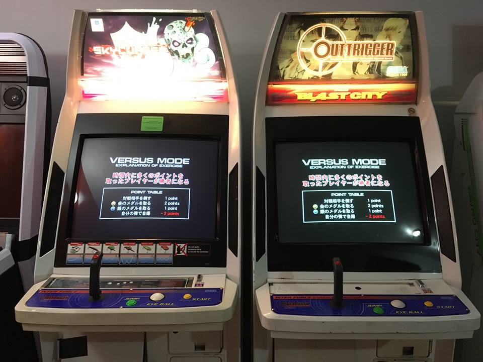

got some time to hang out and work on the old arcade with a friend, we managed to get a few things done ;D
Skate beat us to the punch, but here we go, enjoy some more outtrigger !
doesn't look like it , but testing all that crap to make sure it runs solid takes a bit ...
controls-> cabinet io -> sega io -> trackball io. times 2 , add link cables. lots o wires !!
one of the cabinet had a VS billboard so we switched it out, hoping to get both billboards illuminated the same, all that effort and ...
note to self, get same temp fluorescent tubes :)
f
finally ready ! gotta say the game is real fun, lots of levels , fast action, and it doesn't take too long to get good with the controls.
now , if I could only get 2 more panels... :D

I already realized that :) , this game is very fun in 4 players
I made 3 custom panels with twin sticks to pick up handles combined with LSX-57 seimitsu stick and virtua golf panels for trackball and management card

Yes you can, it's a same trackball but it will miss the I/O board for the trackball that connects to the I/O of the cabinet. It's for this reason I have take a virtua golf panel.
If you create a custom panel you can take a Happ Trackball. Be careful it's almost like a few mm, I think it's because of US measures for the Happ and EU for the Japanese.
The plastic of this trackballs, age very badly, the holes are often broken

yeah the sega trackball are the ONLY ones that fits the sega enclosures ... got a pile of them, I'd need 2 trackball JVS encoders and a dreamcast/twinstick and I could make 2 :D
