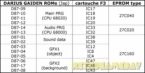

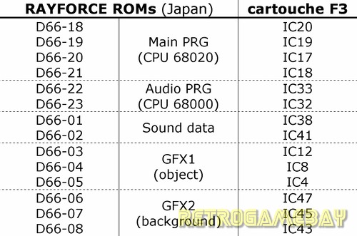

Do you guys have any information about this?
I wanted to convert my taito PB4 into Dan-Ku-Ga but i realize that none of the informations i could find were talking about actual eeprom/prom locations, a part from cpu code (ic17-18-19-20 cpu and ic32-33 for sound code).
The taito F3 cpp is not helping me, also roms aren't because the numbers are not corrisponding to the ic sockets.
Where i can find this type of information?
I was only able to find very little about, like the explained sections of the rom board, and some conversion tables that mostly got the same files in the same ic spots. But other than that, just nothing.

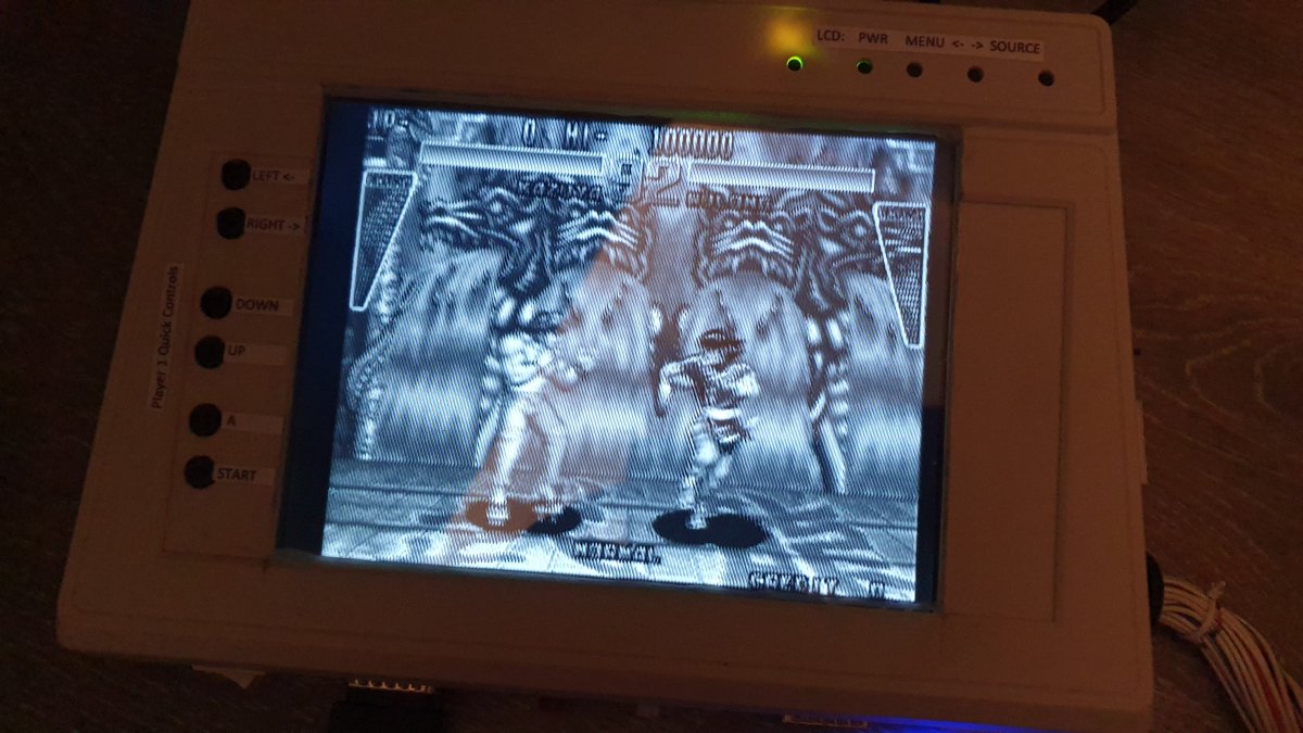

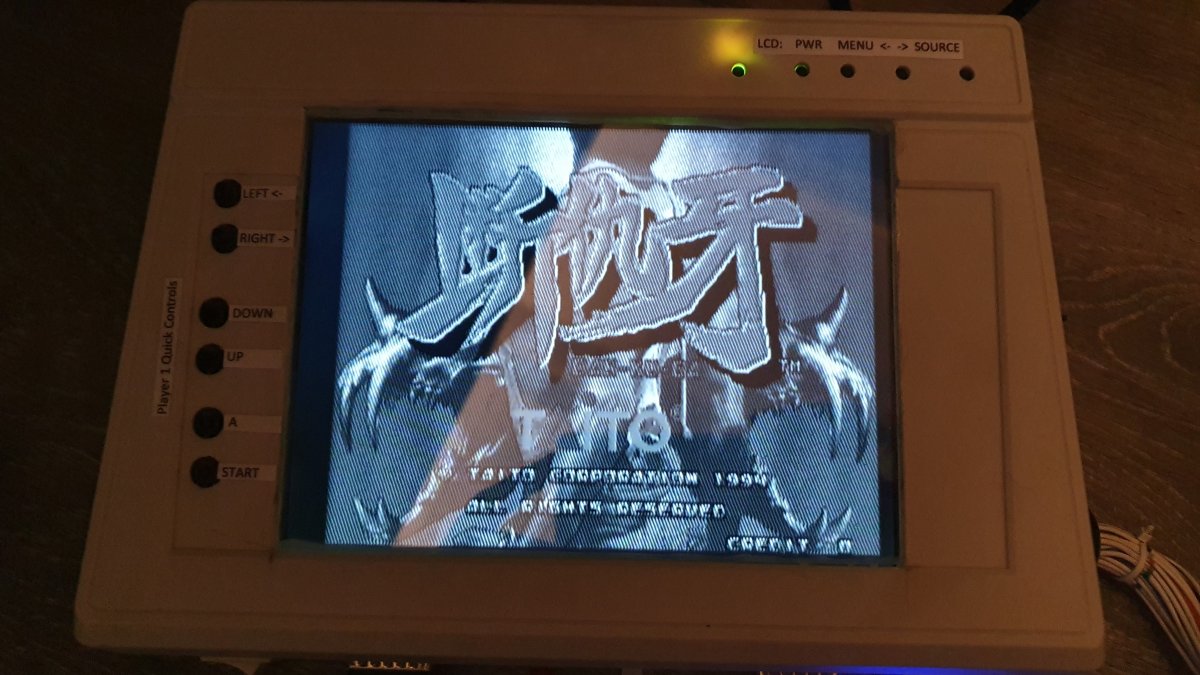

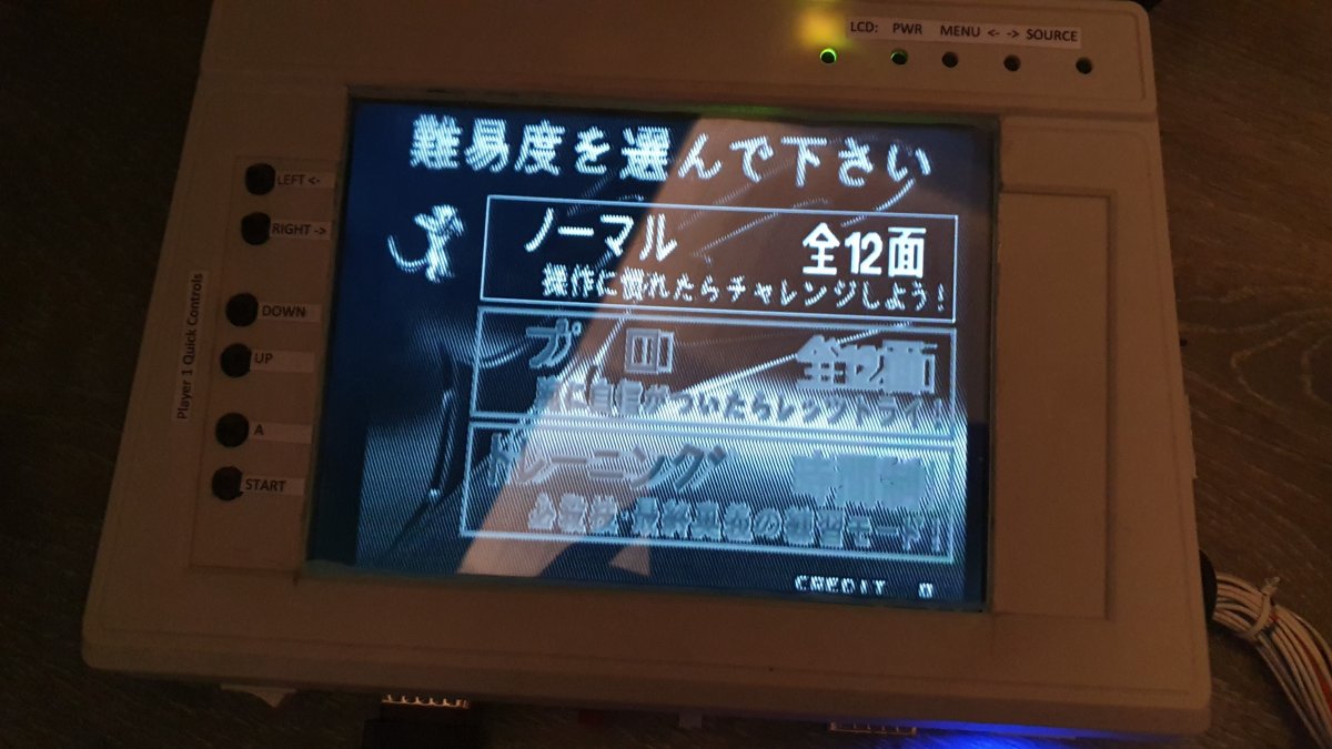

Made it to work after some trial & error :)
(don't bother the B/W screen, chinese rgb to rca sucks)
