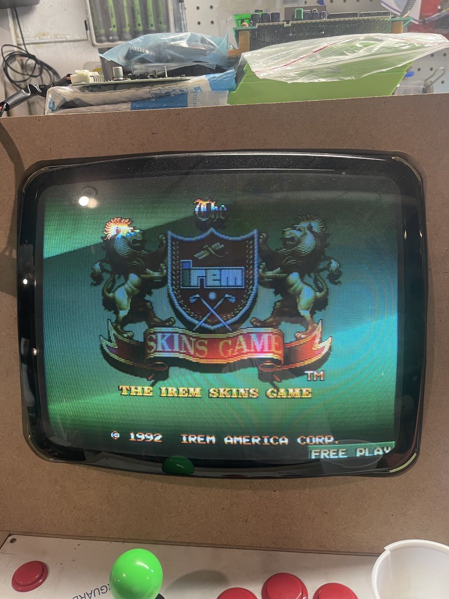

Update!!
It appears the issue is on the main cpu board : i swapped the rom board with gun force and :
Ill try to swap the 3 socketed pals and see if that helps
Edit: nope. not the pals.
