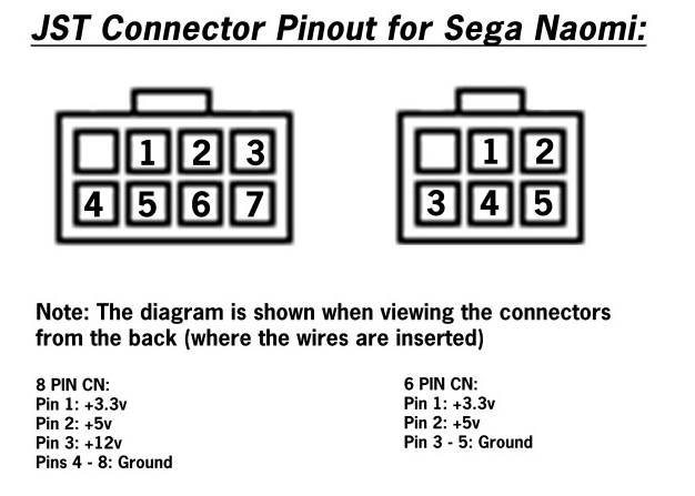

total noob question but where exactly am I measuring for 3.3v e.g. which pin?

You put your probes inside the housing where the wires go in. Top pins are for voltage, bottoms pins for ground.

If you look into the AMP connector, you can see the pins on the wires. Push the probes into those while it's running.
As for the pinout:
getting 3.24 under load.
3.37 without.

Most power supplies don't let you adjust it separately and you certainly don't want to turn up the other voltages.
If you're dropping that much under load it means your power supply isn't providing enough current for the NAOMI, it's a problem of amps rather than volts.
A lot of people try to adjust the 3.3v to compensate but you risk damaging stuff that way so I don't recommend it
Sounds like it's time to buy a Sun PSU!
