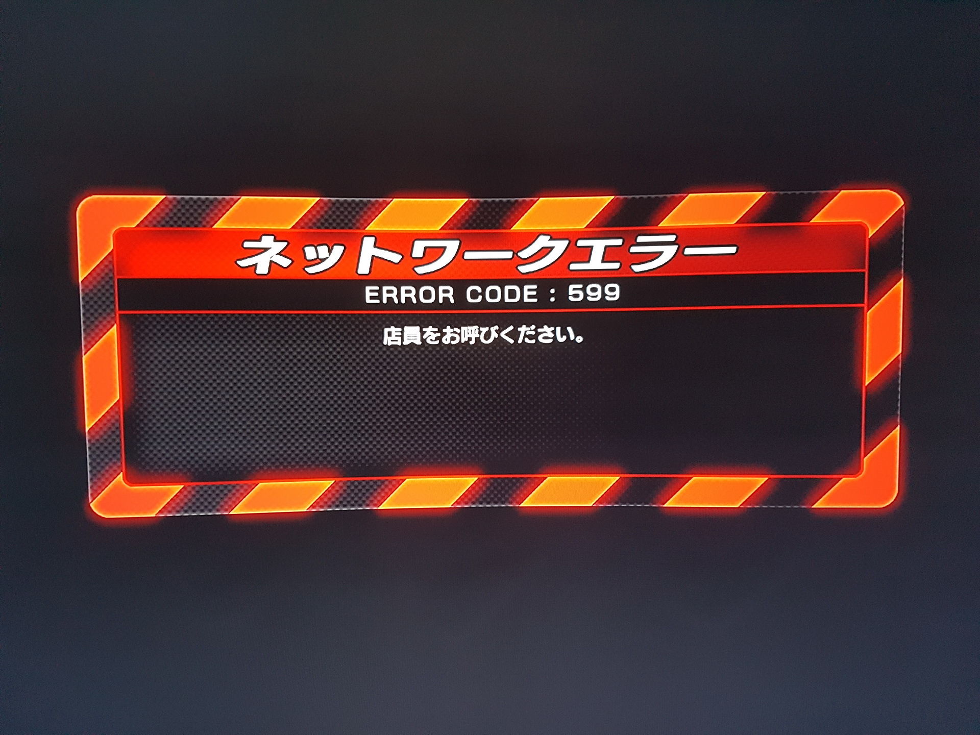

I get an Error 599 when I try to boot my Initial D5 on my Lindbergh.
Maybe anyone can help me with this issue. Maybe someone can translate the message.
It says network error. It is trying to link itself. Go under the setting in the game menu and turn link off as well as other things like card reader or force feeback unless you have them connected
Luke nailed it. But if you were wondering what the short sentence below the error code means, it translates to an immensely helpful "Please call a store clerk." :-)
lol, I thought about commenting on that one but yeah, calling a clerk will get you results for sure haha. :D
Thanks, I got it working somehow. But: I turned the Serverbox flag to "on" again to get it to work. Then I get a DHCP message which disapers a few second later and the game starts.
I guess I am the "store clerk" in that case 8o
