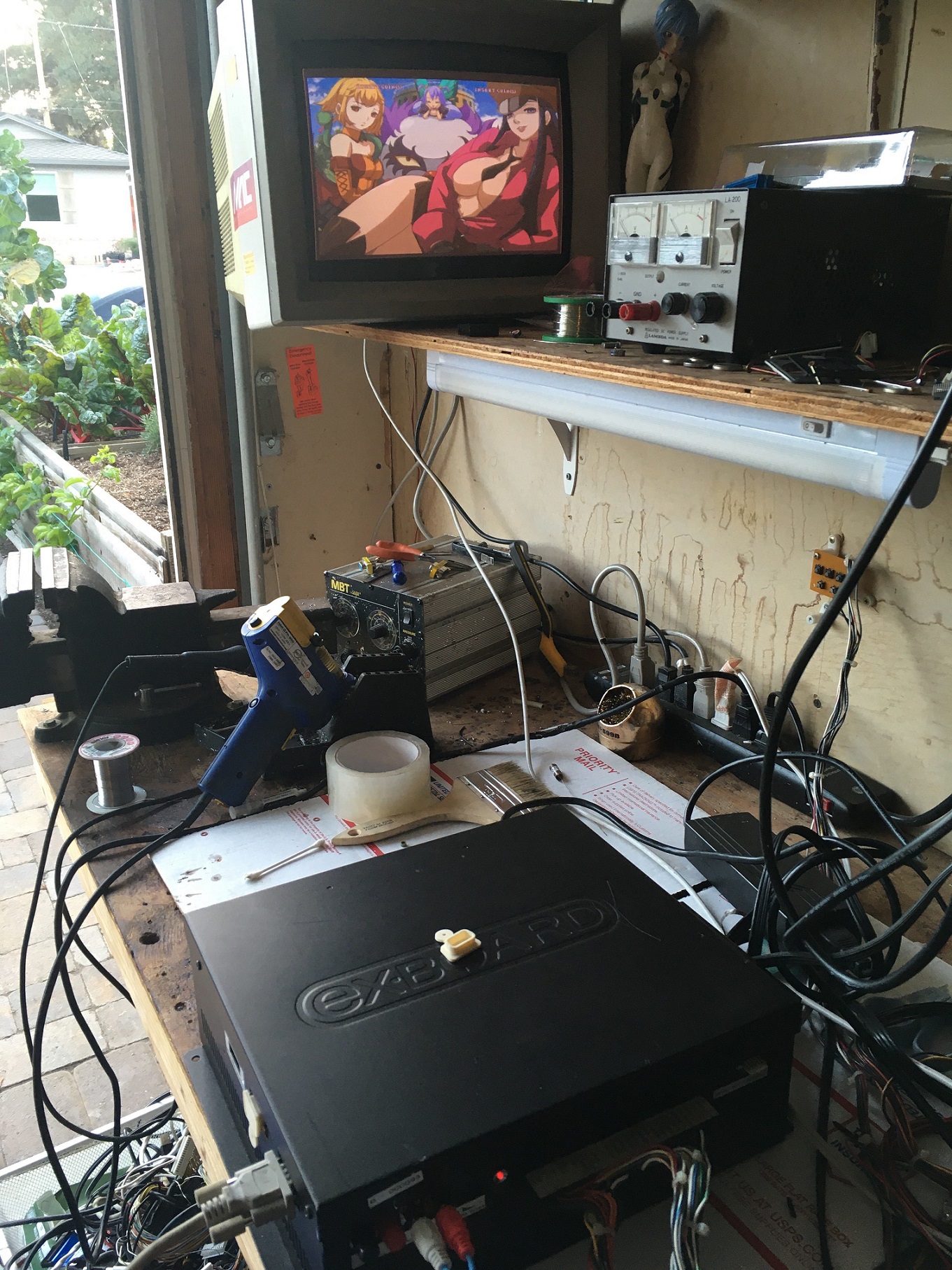

Ok I'm carrying over the discussion from the recent purchases thread...
It seems we have a lot of people who own these boards in a dead configuration so lets pool our resources to crack this nut.
Saw someone was selling a bunch of eX-Boards on YAJ with really low starting bids, so I threw a few low-ball bids on 3 of them and went to bed...
the next morning I discovered I won 2 of them O_o
they're in pretty nice shape and came with the power adapters, no game cards though I have one on the way to help me test and get them up and running.
Open
one up and let’s see what’s inside...for science :thumbsup:

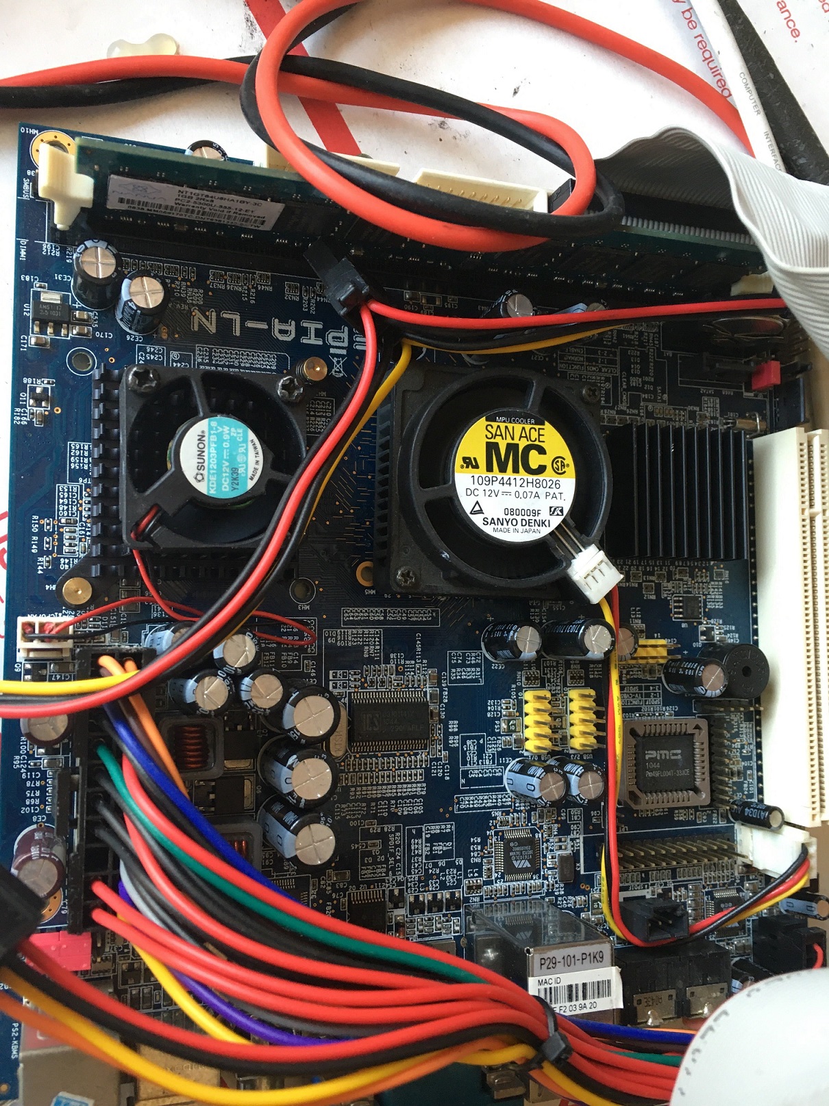

I don't think these are cooking themselves. I think the CPUs are shutting off immediately due to overheating (for some reason the heatsink doesn't make contact with the cpu after a while). It was doing that in mine, so I took out the heatsink and put a heatsink/fan on it and it works fine now. Try putting something really cool on the cpu and see what it does.

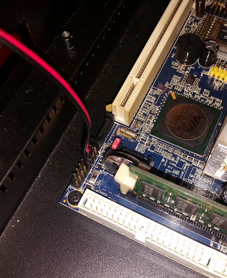

I had some time to dig into mine today... I have 2 of these boards, neither would power on and the battery was flat on both of them 0.9V on one 0.1V on the other).
it looks like there's nothing on the PSU or the mobo to electrically force it to boot, which lead me to believe that it's a setting in the BIOS that tells it to power on automatically. so I looked up the manual and found the pins for the "power switch", they're pins 6 and 8 on the header in the corner of the PCB:
connecting a push button to these wires the power LED comes on and a green LED on the JAMMA board blinks every few seconds, but I get nothing out of the VGA port. I verified good power on all ATX connector so I know that's working. I tried pulling the mobo out of the case and plugging vga directly into it (so the only thing plugged in where power VGA and my power button) and still nothing. both of my boards are like this. I'm even getting power on the PWM fan headers... so there's SOMETHING happening but still no video out.
I feel as if there's something else I'm missing here, is there something else that needs to be connected for this thing to power on?
Maybe bad ram, cpu or even bios?
Does it have a speaker header where you can connect one and listen for the system beeps?
it looks like there's an on-board speaker but IIRC there are pins for one on the front panel header as well, I'll give that a try.
I dug out an old PC speaker and hooked it up... no beeps
I get nothing out of the audio port either (tried both "front panel" header that goes to the JAMMA board and the 3.5mm connector on the back)
Well my first Ex-Board worked after I replaced the battery, cleared the cmos and put a proper heatsink on. Also make sure your bios didn't take a dive.
I've got 2 of them. battery was flat in both so it was replaced. Checked the thermal paste and it was crusty and flaking off so I put fresh paste on.

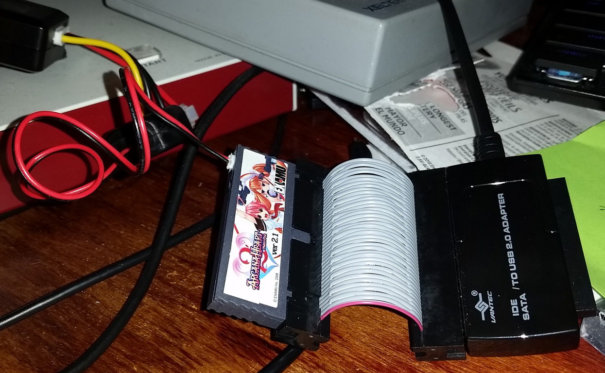

So are the carts on these basically ide flash drives? I wonder if a multi drive image could be put together for these?
