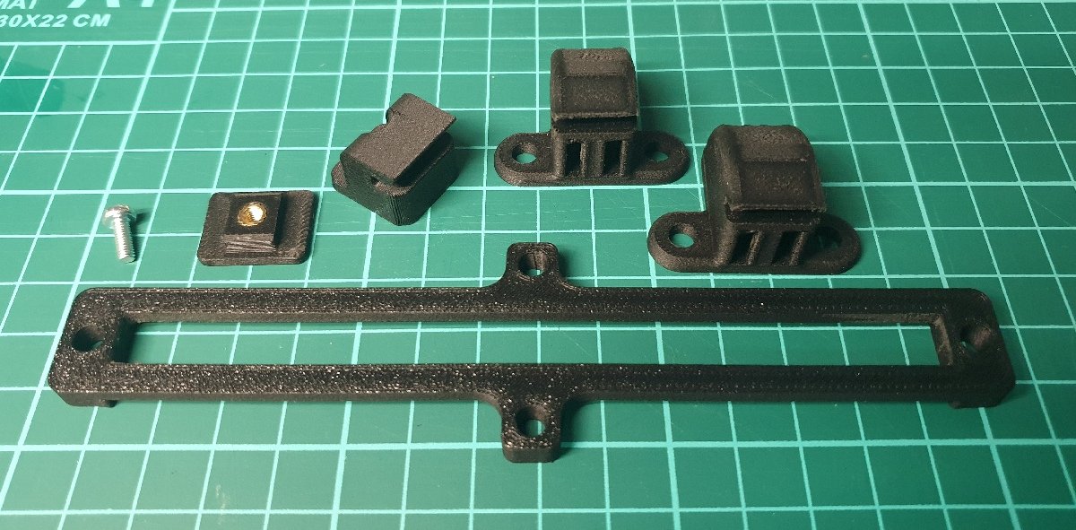

So I wanted a way to swap boards in and out of a cab more easily than unscrewing and re-screwing things to plywood. To my surprise, no one seems to have done this before. (Hat tip to @buffi for their Astro City Holder, which seems to be the only 3D printed prior work).
The goal was simple: make it easy. Buffi's system was great but obviously only good for the Astro City. I have a few different cabs, so I wanted a more flexible solution. The bottom was easy enough: the PCB needs to rest in a groove, that's easy. But the top, how to attach the top with something that can be easily printed? Buffi's system was genius, but of course I wanted to come up with the idea myself. This was the primary goal, but two other goals were reduced plastic use (not that buffi's uses too much, but that I want to use as little as possible) and I wanted a way to more firmly attach the game to the holder.
It took me a couple of days to work this out, and while I'm quite happy with the result. The next revision may allow this to be used for horizontal mounting as well..
I would absolutely love to iterate on this if anyone has any improvement suggestions.

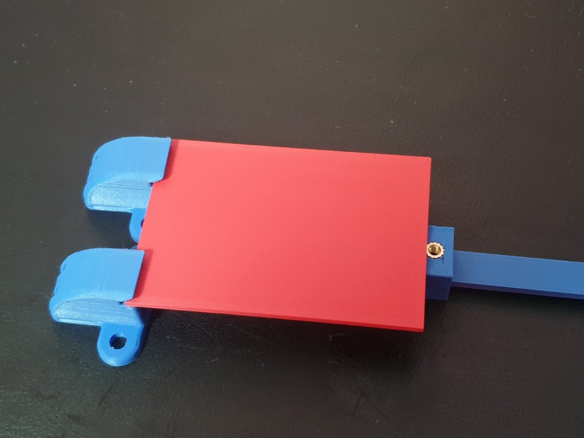

Basically, it's a sliding rail system, with a single screw that holds the top of the PCB to the rail. This does mean that it's still held in place by gravity, but it's definitely not going to fall away from the board. I have a solution for that as well but it'll mean two screws.

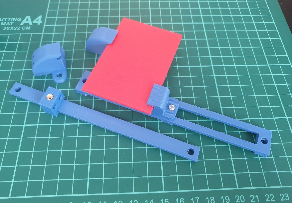

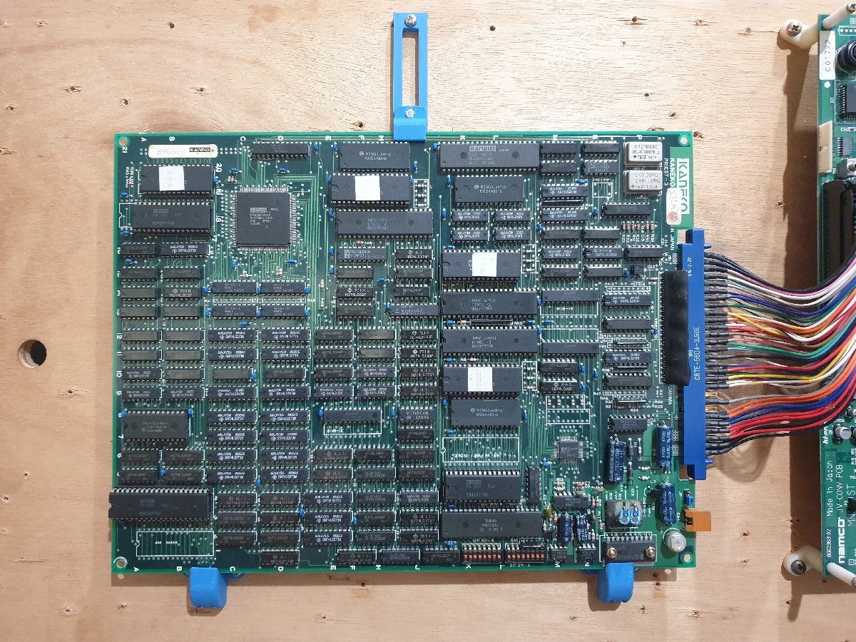

Here's a demo: the red PCB is held in place by two bottom bits, and the screw-hole on top slides to line up with the PCB hole. Since the PCB hole location is unknown, the board can be moved slideways across the two bottom bits, and this particular rail has a ~15cm range, which should accommodate most boards.

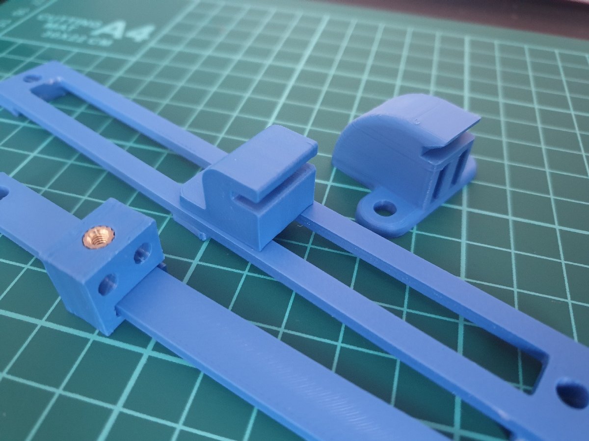

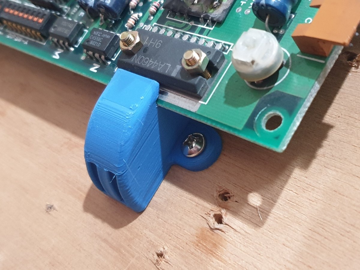

Alright, revision 2 is out, with some tweaked dimensions and a new double-rail screw-lock edge holder. Two or three of the solo bits across the bottom, and one or both of the top lock mechs should easily secure most PCBs with minimal effort, and no more holes in the plywood. ^__^

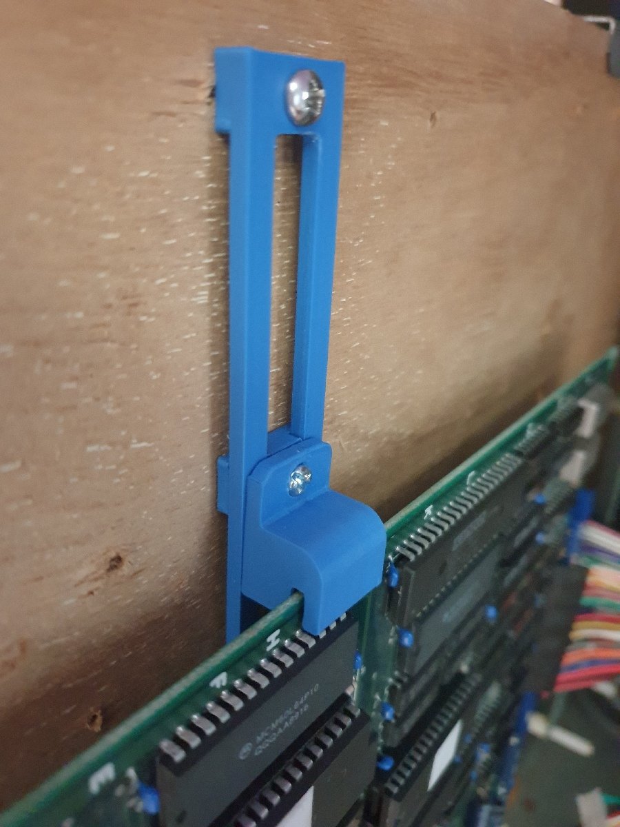

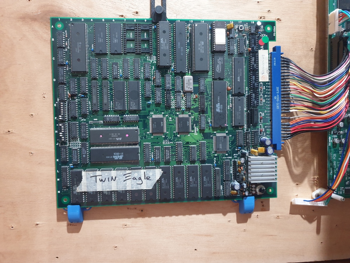

And here it is, installed and way better than I thought it'd be.
I was surprised to find that 28-30cm was almost a standard width for all of the PCBs I measured. It means that the ~15cm range of the top slider could be reduced to 10cm or even 5cm.
I was quite satisfied with the clearances too. None of the blue bits made contact with anything on the PCB. And unless your PCB is weirdly heavy, two of those bottom supports will be more than enough.

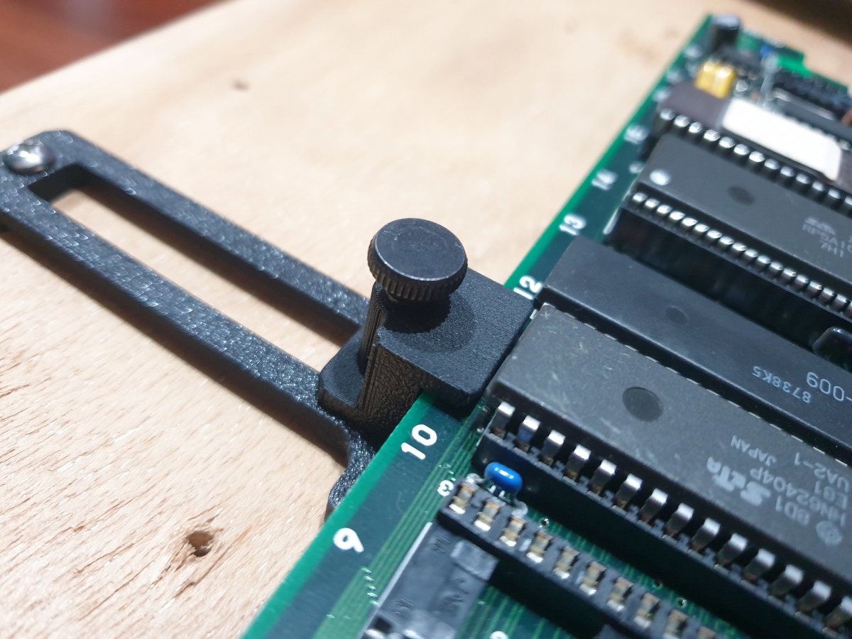

A version of this has been around for years, but I like yours, it's wider at the bottom. Something you can steal from the old one is the knob screw for the moving part to make it easy to adjust.

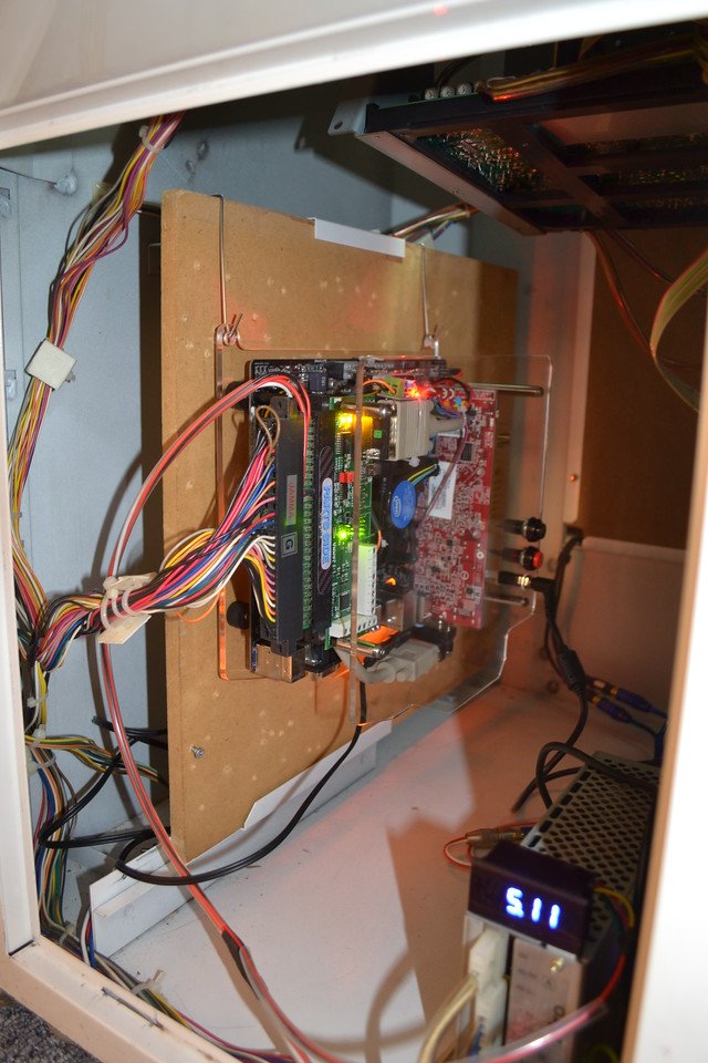

I say almost, and since we're already here shitting on @NFGx's work, if you have a compatible cab, the ultimate E-Z mounting solution is S-hooks. Someone once shared it on Arcade Otaku or UKVAC and it is utterly brilliant.
Pic by @FrancoB from the following thread:
https://forum.arcadeotaku.com/viewtopic.php?p=496040#p496040

The hooks idea is pretty good. My brain recoils at the idea of just leaving a board dangling like that, even though there's not much risk if you're not shaking the cabinet around like it's on the high seas. But looking at it, I think my way is even easier to swap boards. Those hooks are gonna require some careful placement so nothing drops during installation.
Yeah I'd have preferred this, but it turns out the single screw isn't at all difficult to manage so I didn't dig too deep for a solution. I might try a few things, if anyone really wants that option.
The hooks work really well if you can easily slide them along the edge, like on an Astro where you don't have a top rail for the PCB tray.
You can also thread the hooks through PCB feet, so it's not just for naked boards.
If you have a wire clothes hanger around, try it. Easy enough to make.
Alright my excellent comrades, I've made the decision to sell these, at least a few, because I have a photo studio I need to build and the photography biz ain't the career for people who hate weddings and children but still like money. ;)
I'll still release the printable files soon, because I believe in that.
Anyway, a full set in your choice of whatever colours I have on hand. This includes two base holders, the slider rail, and the silder assembly itself with an M3 screw. This is several revisions more advanced, and has been tested with an OG Donkey Kong boardset that weighs in at 2.3kg (~5lb) so I'm quite confident about the load capacity.
$10 for a set
+$2 for carbon fibre filament
Trackable shipping for any number of sets:
$6.5 to Australia
$14 to Canada / USA
$16 to Europe / UK
Prices in USD.

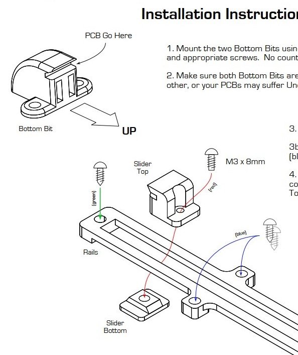

Ships with installation, care and feeding instructions. Does not include screws to mount it to your plywood or whatever.

The knob screw update is go. I'm sending out updated parts to everyone who bought a set.it makes the whole assembly massively easier to use.
