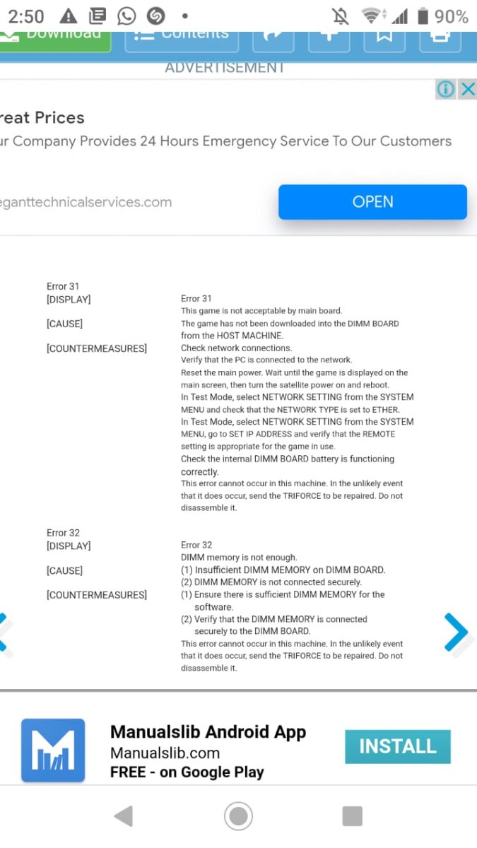

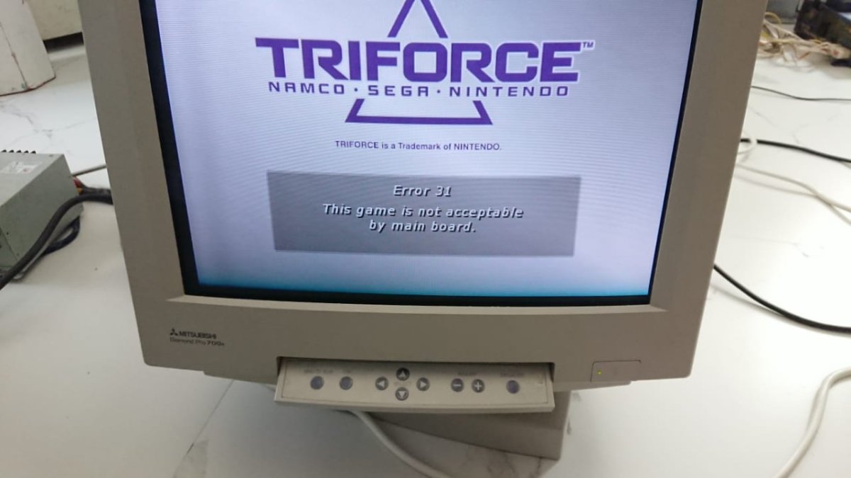

So I bought another Sega Triforce board and now there is a picture but it shows error 31 , checked the manual , tried messing with the network setting , now thing , so does anyone know how to fix error 31 probably?

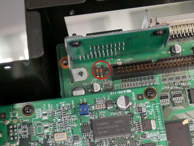

Have checked the jumper settings on Triforce to load from GD-Rom or Ethernet, whatever matches your setup?
That's what I was going to say. You need to have the first dipswitch on SW1 set to OFF if you have a GDROM drive connected.

Update , I switched the dips to off , now it shows error 01 (This game is not acceptable by the main board)

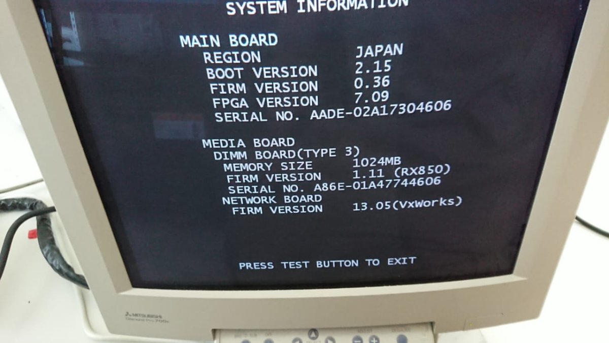

I didn’t mention this before but, when I got the cabinet , the Sega Triforce board wasn’t showing anything on display , so I bought another one from China , and I think it’s Japanese ver
And mine was USA or export I’m not sure
So might the Sega Triforce isn’t booting with the gd rom because it’s region locked , no idea
Is there any other modification can be done to play the game ?
The disc shouldn't be region locked. I originally had a Japanese F-Zero that I converted to Export just by swapping the motherboard region.

An update , so it worked , ok not 100% sure what I have done , cleaned the gd rom laser with alcohol , SW1 is on and SW2 is off , game worked , but unfortunately, steering is functioning well
