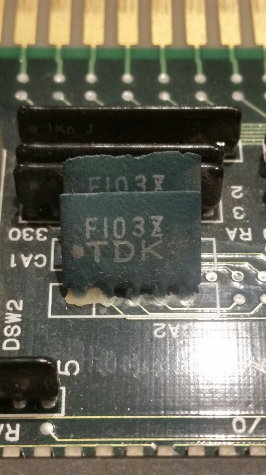

Ive seen this kind of situation with more than a couple of boards, mostly SNK but the Capacitor array marked F103Z made by TDK (5 legs) doesnt seem to have much info on it nor can I find a suitable replacement. Looking to see if anyone has any ideas on this one.

It's a 4 way 10nF capacitor array wired to a common bus. So you should be able to use 4 x standard ceramic caps in place of the TDK chip.
Thanks for the reply Frank. So just (4) 10nf ceramic disk caps with one leg on all tied to common and the other individual legs in each respective hole then Im guessing. Any links to the best ceramic ones for the job?
