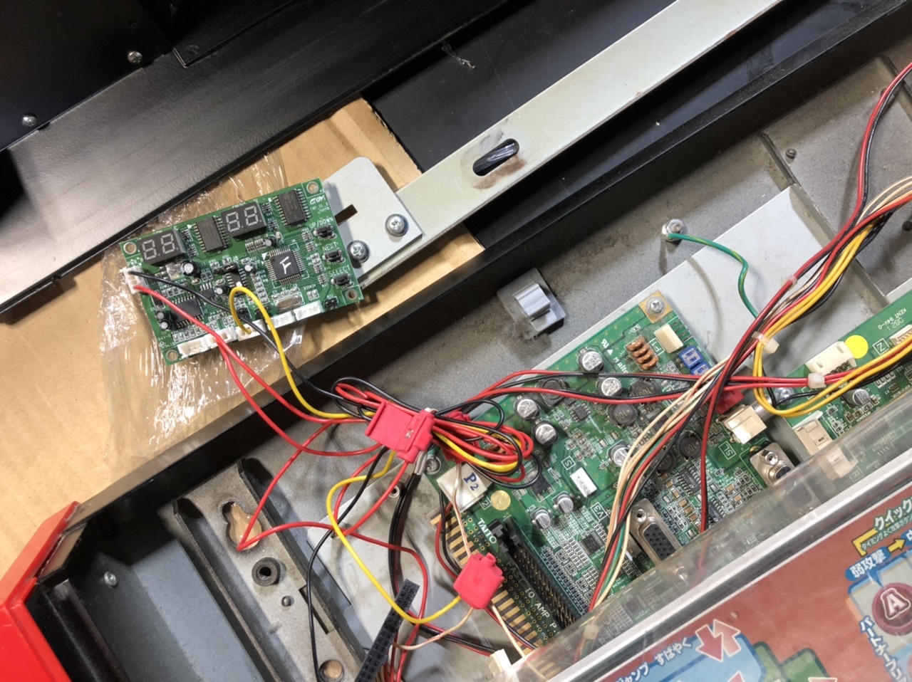

Got my cabinet from KC a few days ago, but waiting for him to get me the board because he couldn’t find it when I picked up the cabinet.

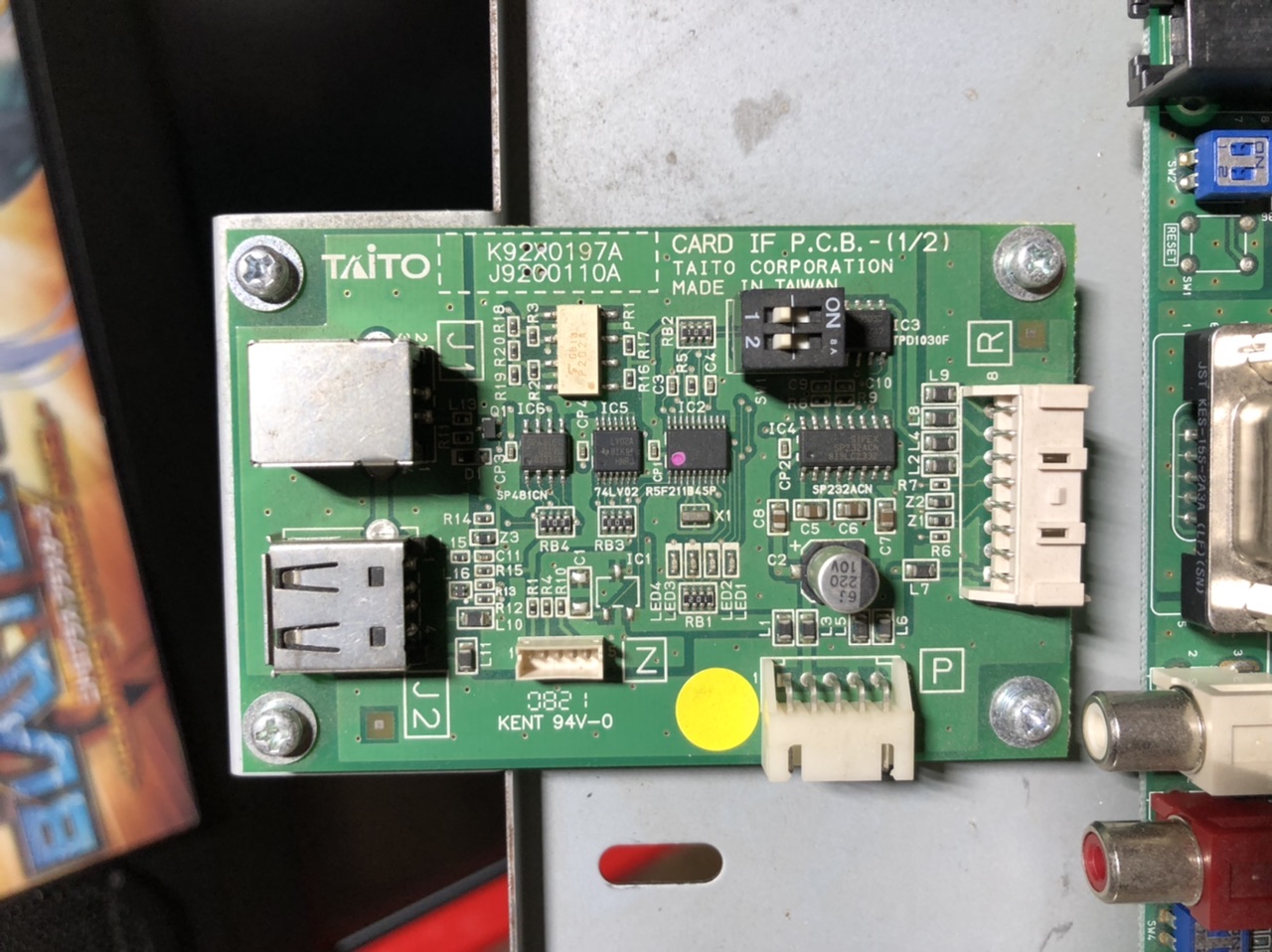

The smaller board has the square USB on it, which I believe is for the IO to the type x2, but how does whatever data from the buttons go from the big board to the smaller one?
Maybe a photo of someone’s Fast IO plugged in would help?

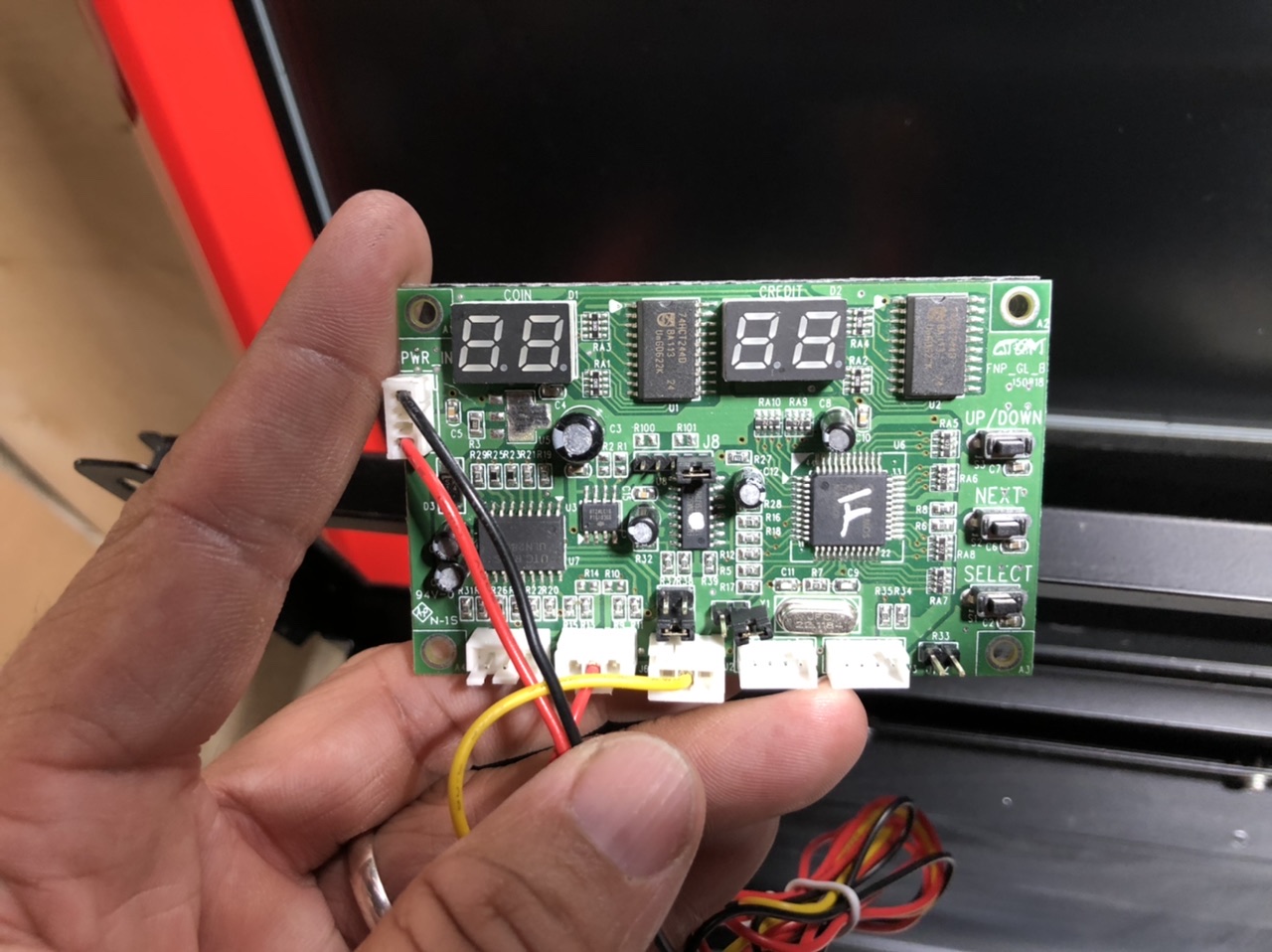

Also what’s this mystery board?

The giant 60 pin connector on the io is what brings the buttons (and other things) to the io.
Yea I got that much, but from the IO how does the signal get to the board? (maybe I'm missing some cables thats making it confusing for me)
With Fast I/O it's an ethernet cable. With a normal JVS I/O it's a USB cable (it is NOT USB spec though, do not plug it into USB devices).

what cab did you get ? , i have that fast i/o in my noir and it attaches to a taito conversion pcb which as the connections for the namco wiring , your mystery pcb i also have in mine , its just a coin counter
