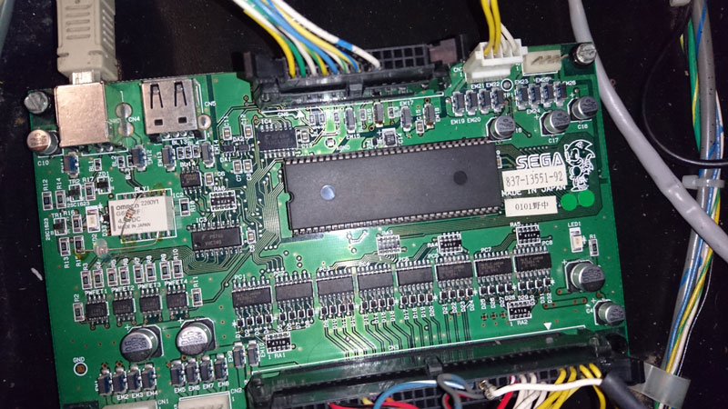

did i see a loose white cable here??
Wait a minute! That's going to be the issue, I think! That looks like a coin meter spoof wire.
I have a coin meter removed in my cab, so my Type 1 I/O would be in the same condition as @Omni11, and that's why I'm getting the same behavior!
I just plugged in my custom I/O that reports no issues with coins (i.e. coin meters present) and Faster Than Speed boots and plays perfectly in my NAOMI 2!

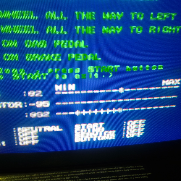

In my limited playtesting on my custom I/O, it looks like controls are working fine. I noticed on FTS for the brake pedal in calibration I'm seeing where the analog value is jumping quite a lot and automatically filled in a large portion of the meter before I pressed it in. I honestly don't know if it's a matter of me reporting the value incorrectly or if it's interpreting something incorrectly, but I think I'm handing that channel the same as the others. The brake pedal appeared to work correctly in game, though. It's not like it's auto-braking or anything as far as I can tell. I'll post a pic of the screen when I get a chance.

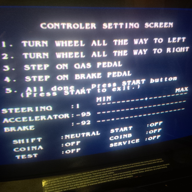

Here's a pic of MS calibration for comparison:
The brake value consistently stays at -92/-91, leading me to believe the FTS brake issue isn't due to my I/O.
weird question but is the brake signal split across 2 analog inputs? if you set analog values for channel 3,4, etc. does it effect the brake value on the input screen?
That's an interesting theory.
My only evidence against this is that for all other channels not in use, I'm reporting 0x00 without actually reading any analog data on my Arduino, which should NOT equate to 0 on this meter. This meter treats 0 as the center which would be around hex value 0x80 reported by for an analog channel.
