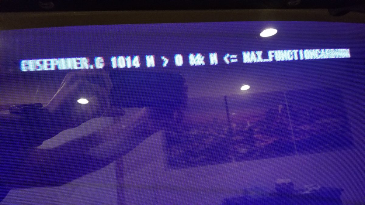

I just bought this Dragon World EX cart. I cleaned it with Deoxit D5 before testing. It seemed to play fine until I cleared the second stage in Beginner mode. That's when it crashed with an error message. I then rebooted, and it no longer displayed a region at the boot screen (it was Taiwan before; now that space is blank). When I started the game, it seemed to suddenly begin from the end of stage 1, where it's counting up the points. It then proceeded to stage 2, and it was suddenly playing the Japanese voices for the game. I lost and quit the game. I then started again, and it once again resumed mid game. I decided to reboot and reset the PGM's backup memory. After that it wouldn't start the game at all, crashing with the attached error screen upon selecting Beginner or Expert every time. Characters are also now missing from the title screen.

I then played Dragon World 3 and Dragon World 3 Special on the same motherboard (those two games both work fine as usual). Then I switched back to the new Dragon World EX cart, and now it won't boot at all. It now goes straight to this screen.
Anyone with any ideas which part has gone bad? I've already contacted the seller.
