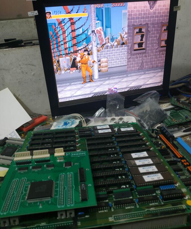

After a little nagging I got Grego to release the pal. It's in his github (where you download the original 30th). Roms go on 5-8 in the following order 5,7,1,3.
I got it going on real hardware (SF2:CE) but have yet to actually field test it. I was planning to do it next month at my friend's arcade but the city is in some what of a lock down state.
I would like one who know some coding as I suck at it to make it work on 90629-2 and cps-b-17 :)
