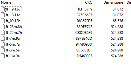

Seems this is all file that i need without pal, is that correct ?

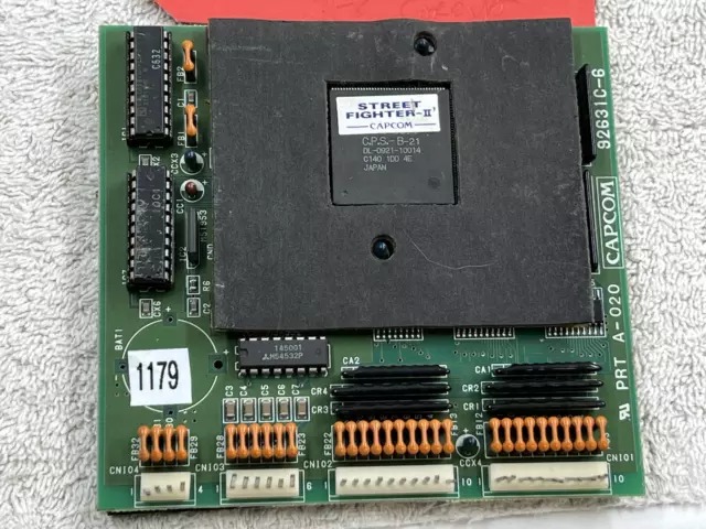

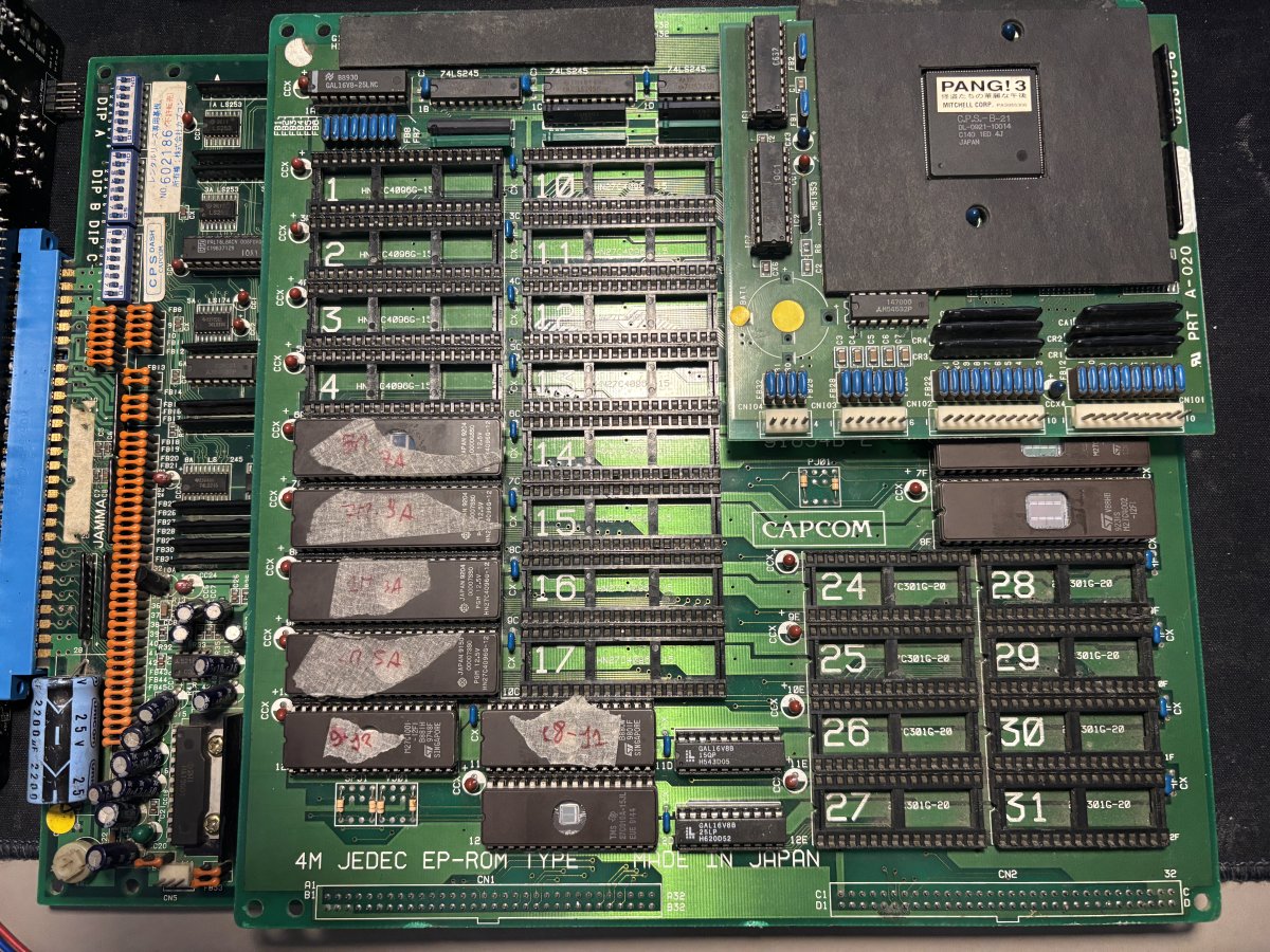

Can i use Pang 3 board or i should use FinalFight ?
Can i use 27c4096 or 27c4002 for 512k file and 27c010 for 128k ?

I think I can't use Pang 3 so I'll try to use the original FinalFight board and change the roms to the modified AE ones.
I think I guessed that for the third player you need this c board. But how should the keys be mapped?

Eprom order:
Slot: 5,6,7,8 for the graphics.
File order: 5m, 7m,1m,3m
You need EP-Rom B board !
