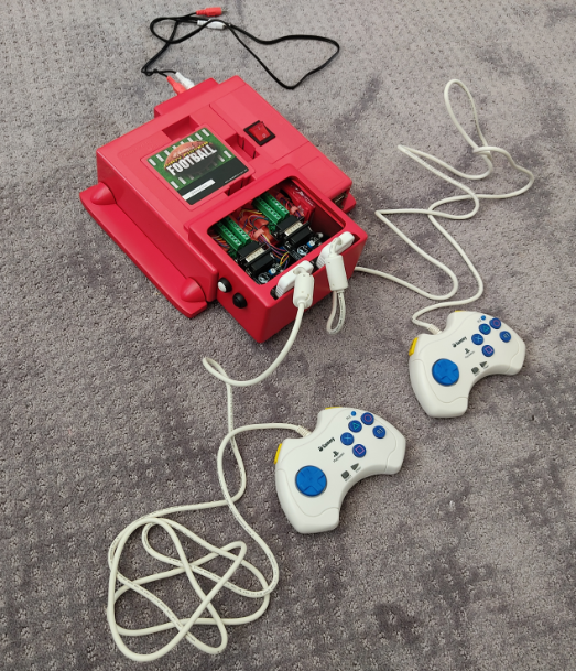

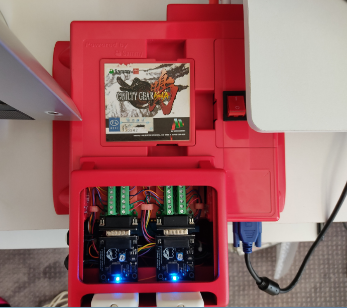

Here is my first attempt at consolizing. Almost done with it. There is a top lid that is missing from the picture, as well as a badge. Both are currently coated in primer and awaiting paint. I wanted to make a modular setup that I could swap to another Atomiswave if anything where to happen. Also I wanted to be able to do everything off a jamma connector and leave the motherboard as stock as possible ( audio points aside).
Using Sammy Guilty Gear PS1/PS2 Controllers with Retroelectronik adapters. Only ones I could find with the 5 button atomiswave layout and really wanted Sammy controllers to use with it.
I will update the post when its totally finished.
