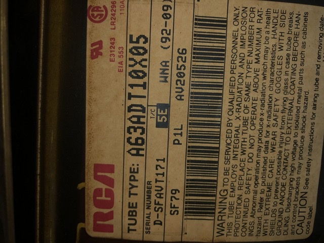

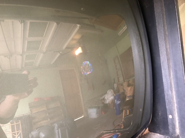

I’m attempting a monitor swap for my Neo Geo big red. I have an rca tube A63ADT10X05, which is indicated as being a great match for a WG 25” K7000 chassis, which I have hooked up. I hooked up everything and all I’m getting is what is in the picture below, a small blob consisting of red green and blue. Has anyone seen this before?

I haven't seen that before, but my guess is you've made a mistake on wiring the yoke. What have you done exactly?
Took the yellow and brown vertical wires from the monitor and spliced them to the green and yellow wires connected to the molex for the K7000, same with the red and blue horizontal. I keep reading a lot of different values for the yoke resistances though. This monitors giving me 5.5 ohms vertical and 1.5 ohms horizontal.

5.5 ohms is probably too low, but I'm not sure it would cause the issue you are seeing.
Vertical shouldn't matter that much. I don't know, I still think you have something wrong with your yoke wiring.
