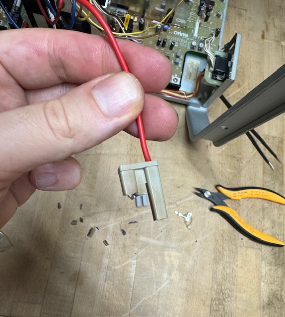

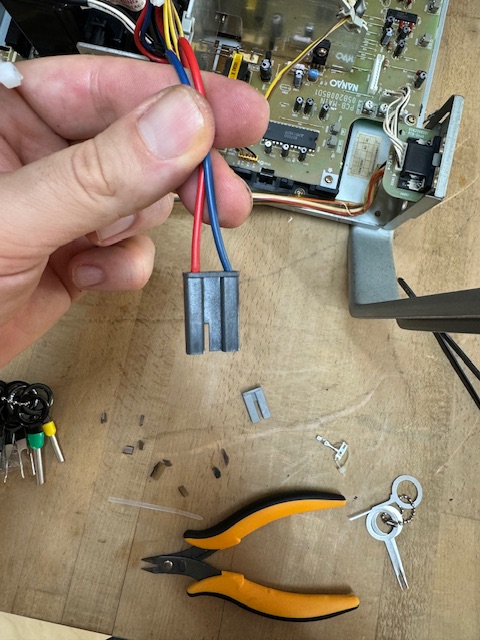

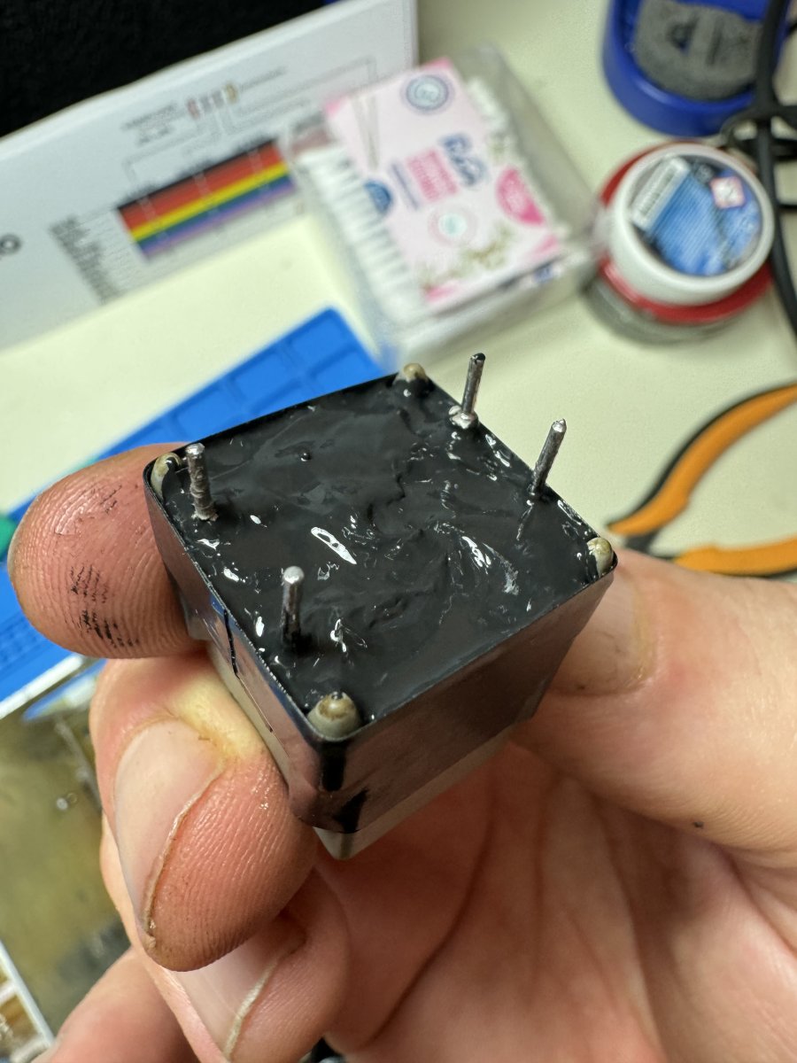

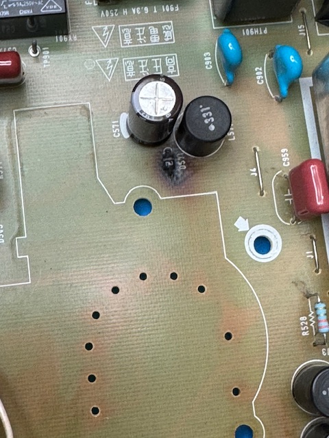

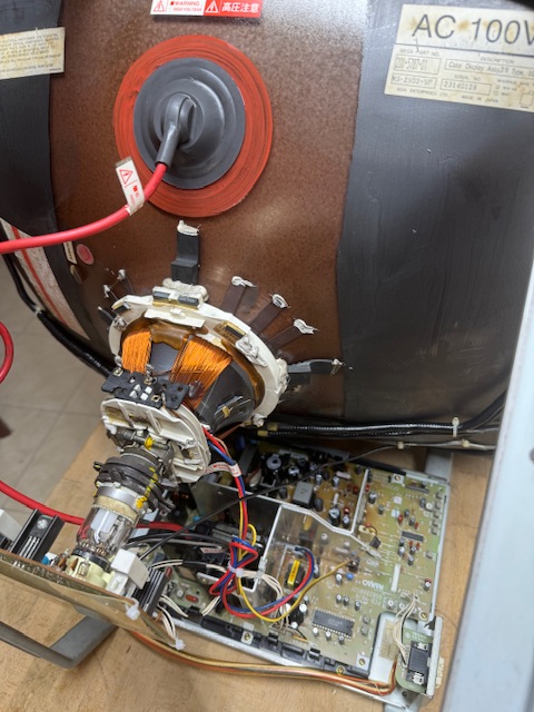

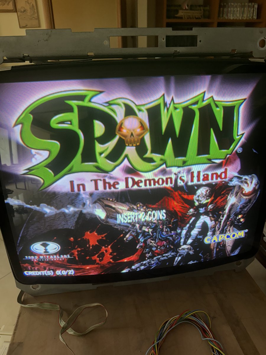

Good morning guys, I show you the repair and restoration of this beautiful MS-2932, found in a Naomi Universal Cabinet. The monitor showed no signs of life, both due to the death of HOT and the diode on the XRAY circuit. I also had to remove and fix the coil which had sprayed resin all over the frame, probably damaging HOT. I also had to fix the yoke connector which was broken, now it works perfectly and is ready to go into an astro city
