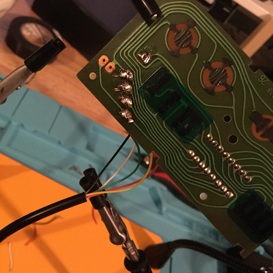

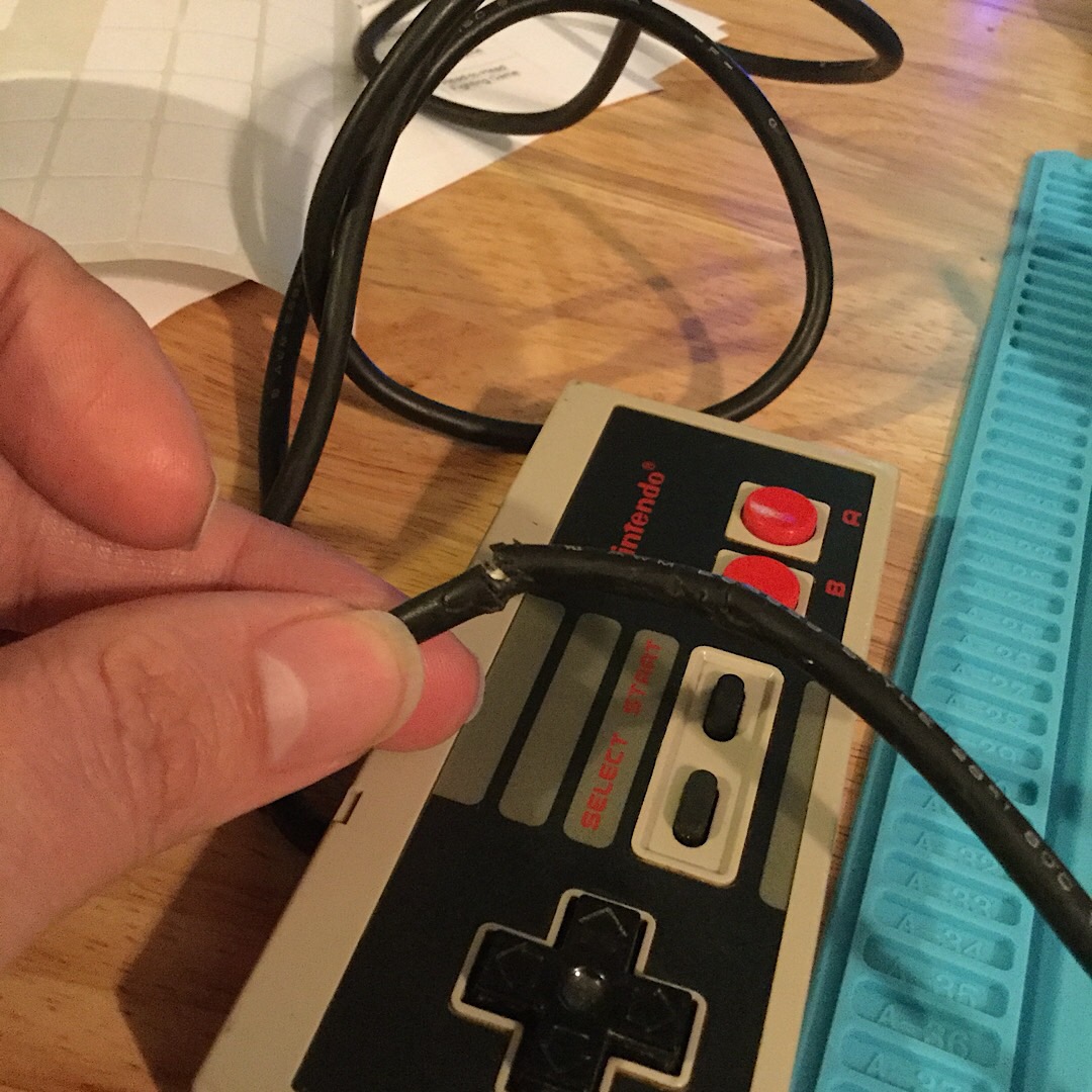

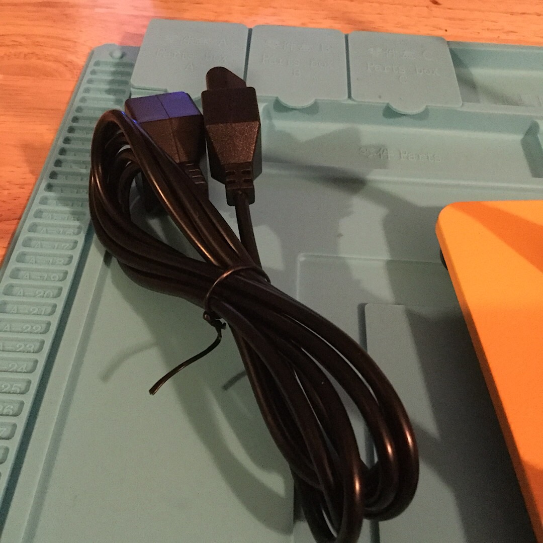

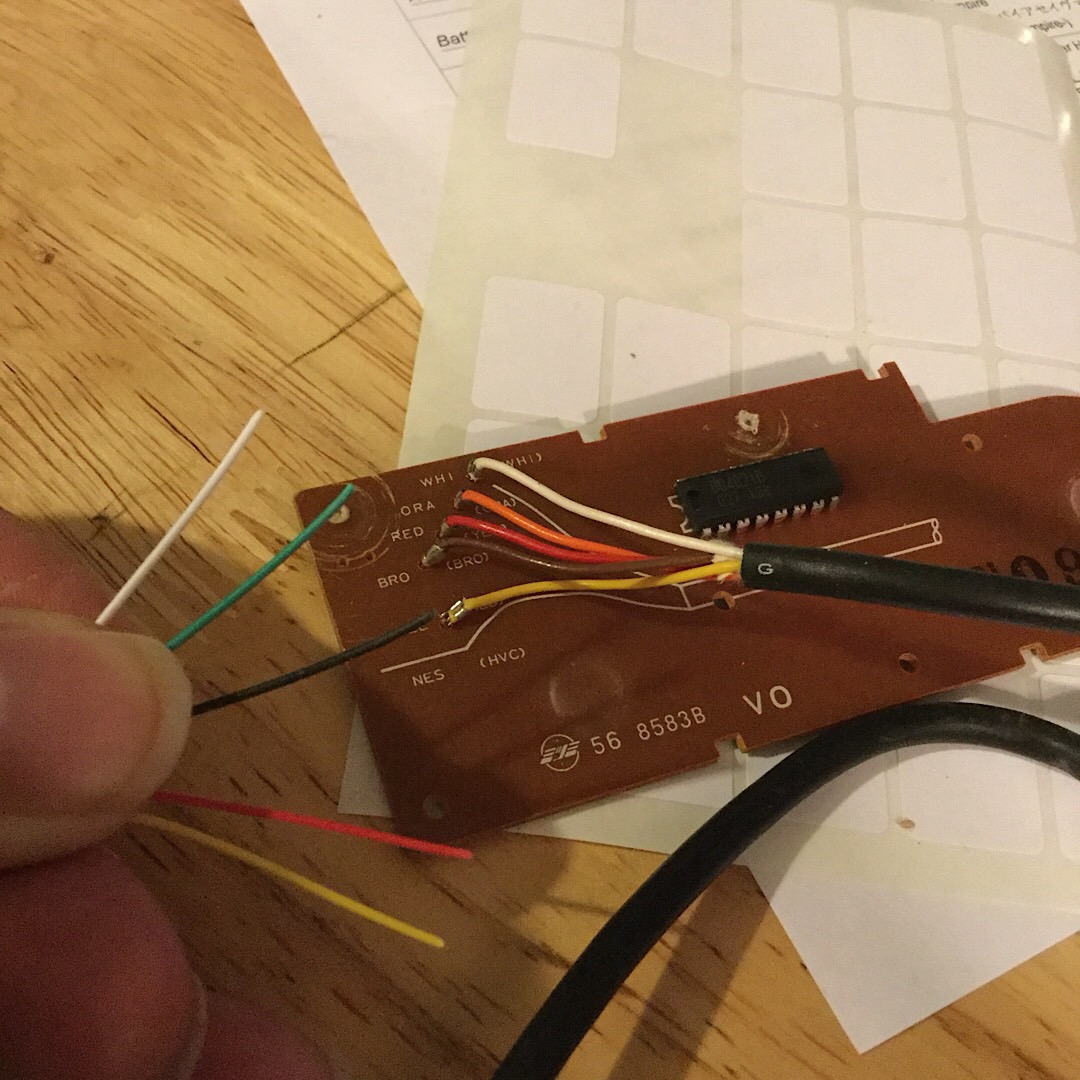

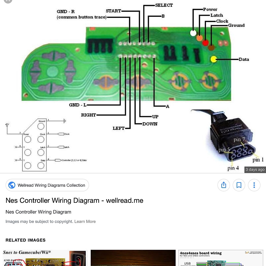

Stupid cat likes chewing shit. Got some controllers that need some work. Some nes and tg16. Starting with a nes controller. Had to drill out some of the screws that wouldn’t turn. Cable colors on the original and this extension are different of course. Found a useful diagram and used a multimeter to map how the extension is wired and matched it up. Some bush league soldering later and I have a working controller! I’m a complete noob when it comes to this kind of crap so I’m happy with myself. Now I want to go fix more junk. Hopefully I don’t burn or shock myself but we will see.
