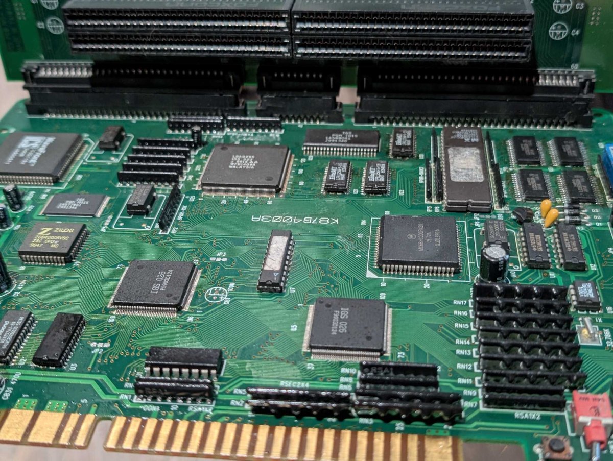

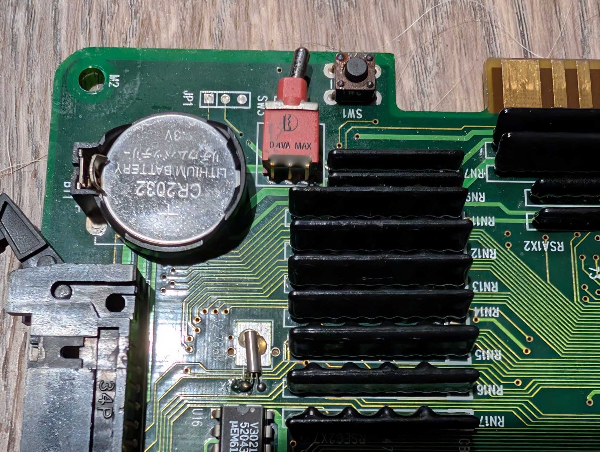

Images as requested. Battery area looks good. As mentioned, there appears to be zero response to power on, whether or not a cart is in. I didn't test the coin cell for charge, is that necessary to boot? Is a cart necessary to boot (I presumed it would at least have some rudimentary "Put in a cart" screen)?
The residue visible on the edge connector is DeoxIT.

You should have gotten it from our own Sheep Nova here, that one looks a little worn...
That being said, it's a v14, so no leaky battery problem, b/c it's a coin cell, but pull it just in case, you don't need it. Look under it and around it for leaks.
If you have the magic Deoxit, put it on the cart connectors, both on the mobo and on the right angle part. Plug and unplug all the parts a few times.
Obviously, you'll need a multi-meter to see if you're getting a clean 5v on the PCB. If so, move it up to 5.1, my PGMs eat the juice.
and I mean, you can pull off the part in the back that says FOXCONN, just gently pull it off. Deoxit the shit out of it.
