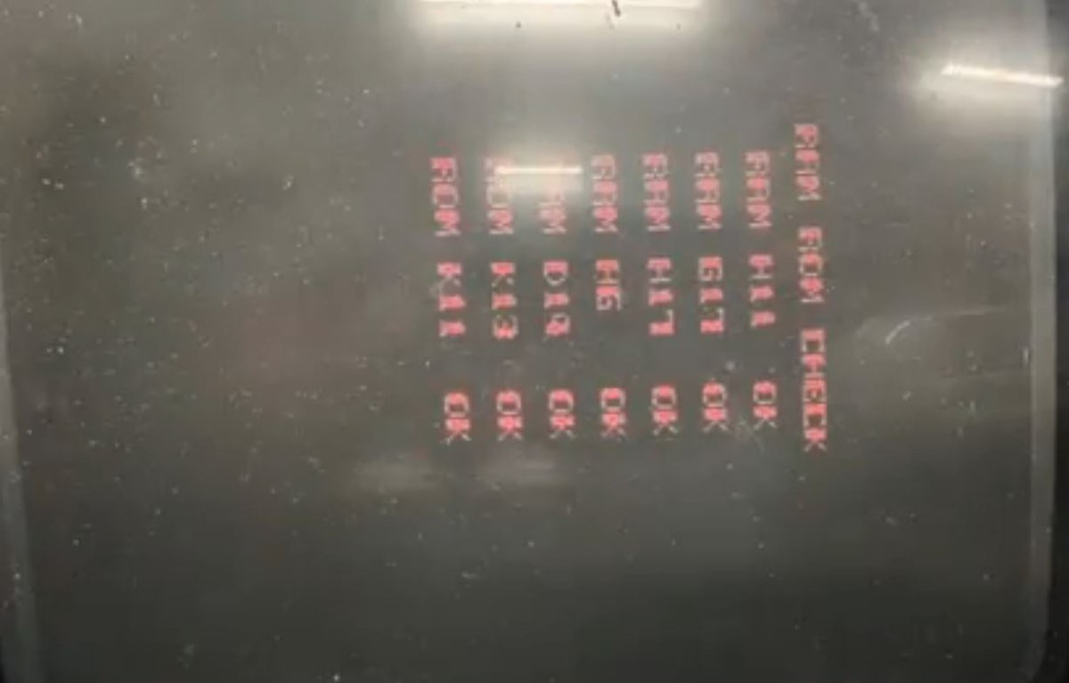

@Nebula sent me the 3 files and I got 3x MX27C4100 EPROMs programmed. Now I can see that it boots, does the self check, and then gives an OK screen before rebooting.
Odd thing is if I short data pins on G17 it says H17 is bad, and vice versa. The DIP switch to go into "service mode" does not work. It reboots before going into that mode.
Also, the hybrid gets uncomfortably warm. I'm wondering if it's bad - thinking so based on the red text. Luckily I have one on the way from Caius. It's just taking forever for the post offices involved to get it here. Also wondering if I need to replace the 051961 custom since it's connected to the 051962 that I already had to replace.

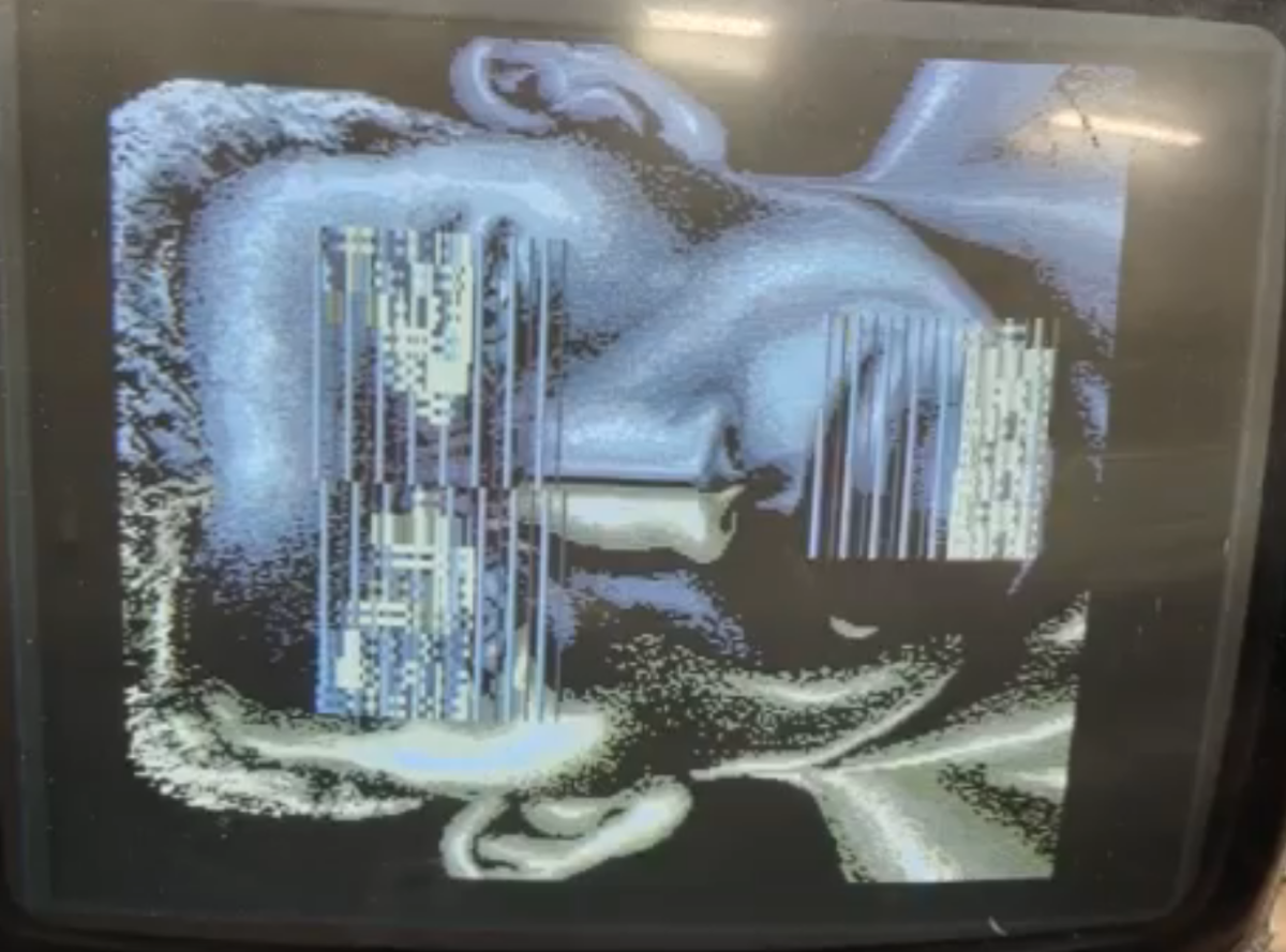

Replaced the custom and it's working... BUT... There are graphics problems with the player elements. Time to look at the 051960 and the 051937 customs. I'll start with the custom that had the dead ROM attached to it.
