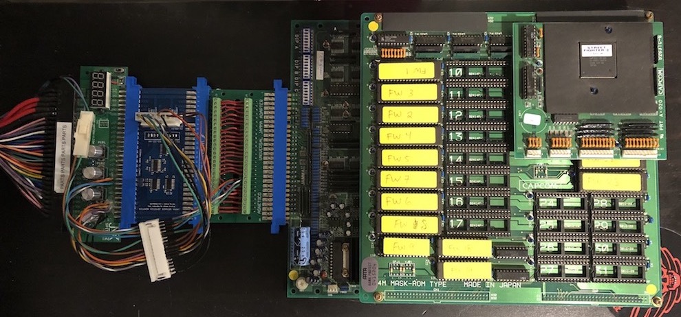

First step was to get Apocalypse’s FW roms burned and my SF2CE converted per his instructions. Worked like a charm.
http://arcadefixer.blogspot.com/2017/03/conversion-sf2-to-forgotten-worlds-cps1.html

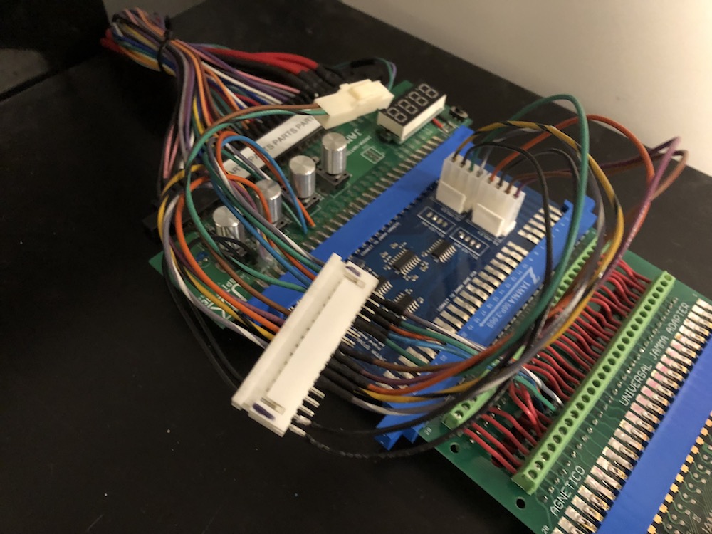

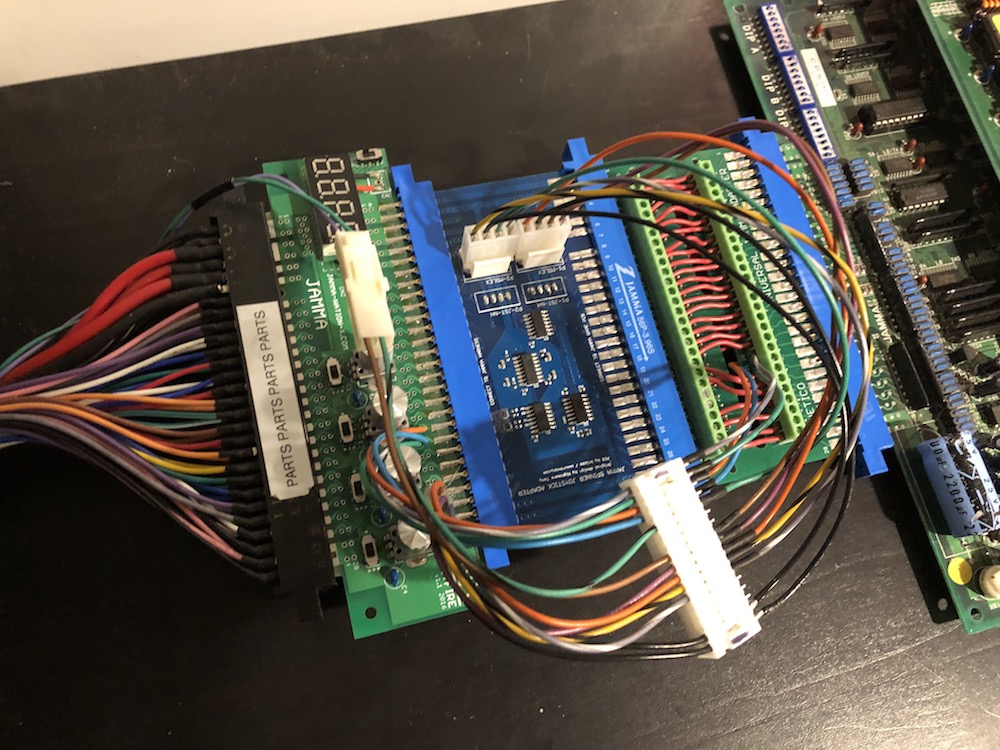

Next step was to wire the spinners and other inputs through the stock internal wiring in the E2. Luckily I was able to use buttons 4,5, and 6 for the spinners and then wire it all into the Brizzo board. This was accomplished by pulling the inputs from the JNX adapter I always have connected and into the attached CPS2 harness I normally use for CPS2 games. There were plenty of open spaces on the connector so I used it to then connect the spinner inputs over the jamma edge to the Brizzo Board. I really like that I didn’t have to add any additional wiring inside the cab.
This was all well and good, but it still meant I needed to reroute the L/R output of the Brizzo board to button 2 and 3 so that the spinner spinning left and right would essentially be button presses for buttons 2 and 3. That’s what the final board in the chain is. It also allowed me to take the standard L/R from the joystick on the jamma edge, and reroute L/R coming off the Brizzo board into the 2,3 button inputs. I wish I came up with and easier way to do this, but after a lot of wire cutting and stripping. It all came together.
A critical element to this was I needed to nullify the L/R from the joystick and all the spinner inputs on the jamma edge as they went into the Brizzo board. If you don’t do this then L/R will not only move you left and right but also spin. After racking my brain on how to fix this problem, the exceedingly simple solution dawned on me of putting some thin tape over the appropriate inputs on the jamma edge of the Brizzo board. Then everything worked perfectly.

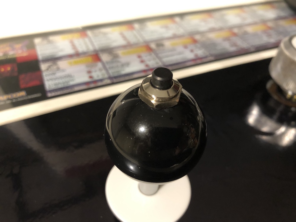

The final piece was the fire button. I used 4 gear Taito spinners for this project and of course there’s no fire button on them (Taito spinner conversion coming soon, very interesting indeed). And the most simple solution I could think of was putting a button on the top of the balltop. After a bit of button research and some rough depth measurements, I found a latching button that would fit, drilled into the balltop, and mounted the button inside. I’m using JLF’s as joysticks so I installed a Kowal hollow shaft and ran the button wires through it. Easy peezy.
Overall what I really like about this button setup is I get all the spinner control, but I don’t have to hammer on or hold the fire button the whole game. And honestly, I’m firing pretty much the whole game. Separating the spinner mechanic from the fire button I think may be an arguable improvement to the gameplay (but the last time I played FW on real hardware I was a kid ;). The fire button works if you tap on it too so you can easily do the screen clear if that’s your thing. I know there are a few weapons in the game where button locked firing isn’t functional, but I never use those weapons in the game, and if I decided to, the button works tap style also. Check out the play:
