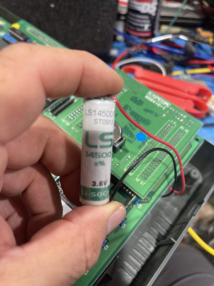

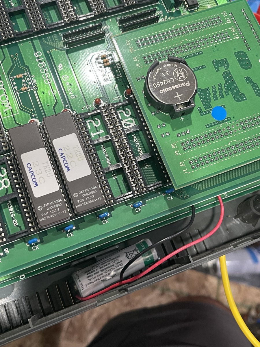

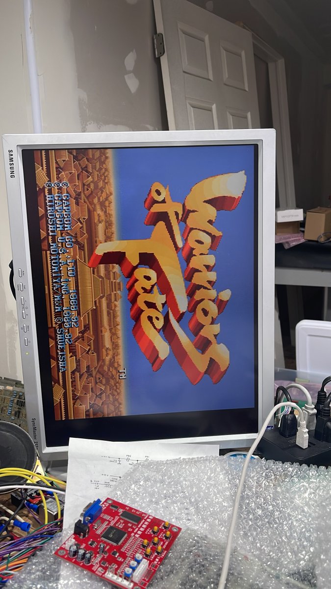

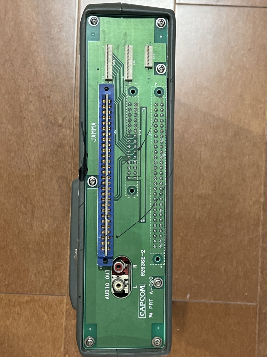

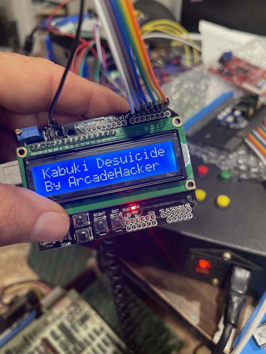

Desuicided/reprogrammed both C-board and Kabuki CPU.
I replaced both batteries. Zero battery damage from either battery.
Kabuki board battery is remote installed off board and way, way, way larger 3.6v battery than original 1/2aa . I used one we put in scuba computers.
C board battery replaced with 2450 which is approx 3x larger capacity. This is a coin cell but not to be removed. Game will suicide if you remove. Dab of hot glue holding battery in place so it doesn’t pop out by mistake.

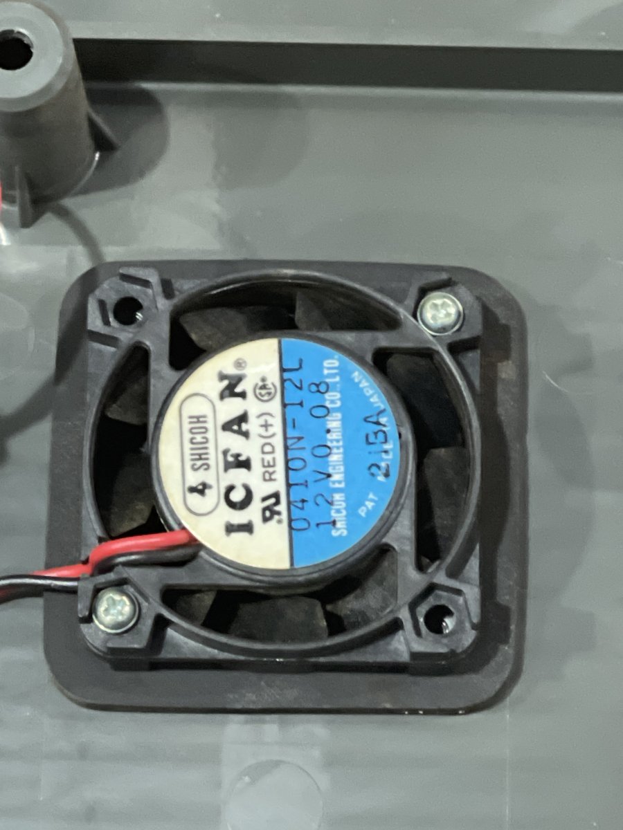

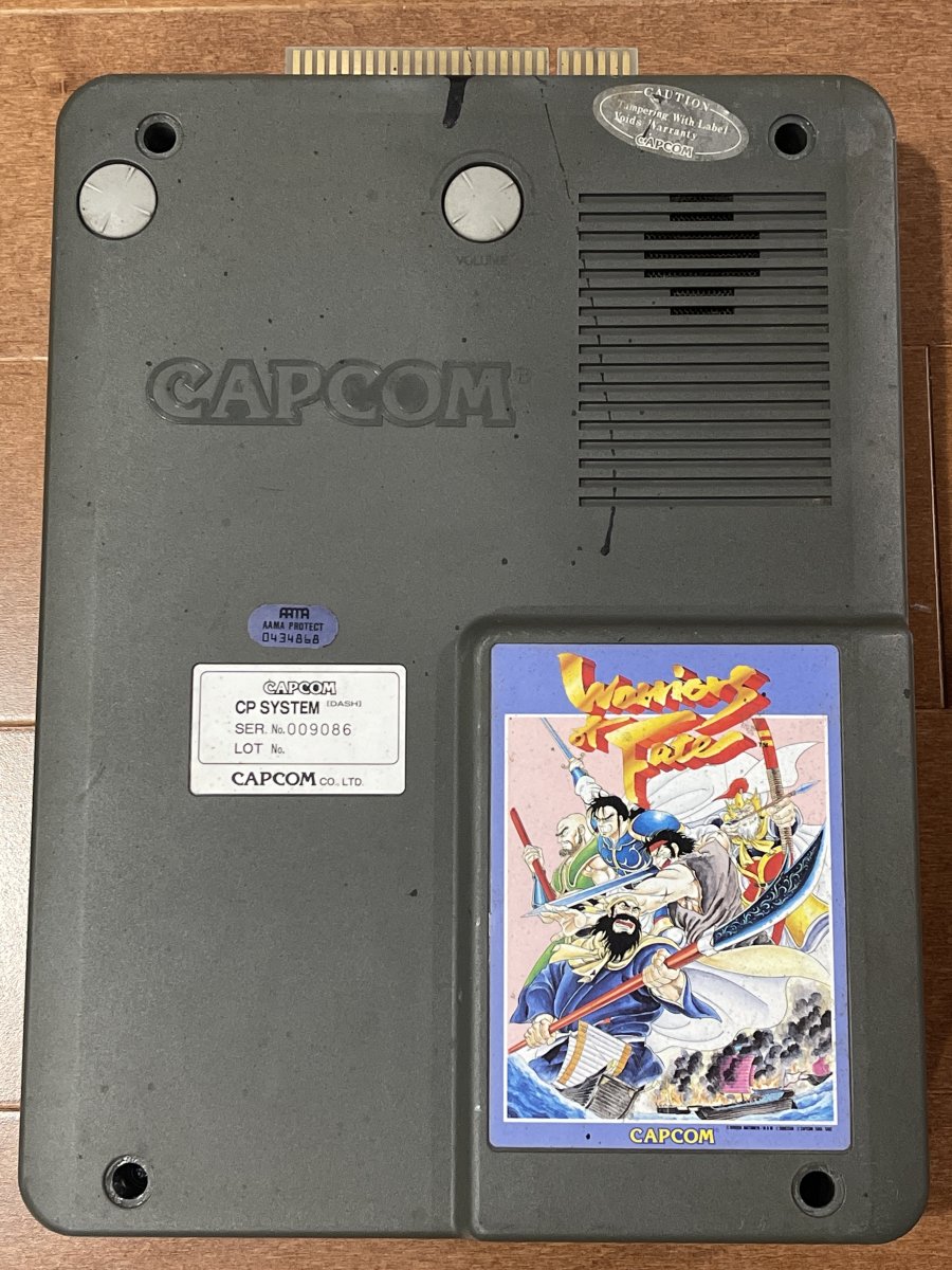

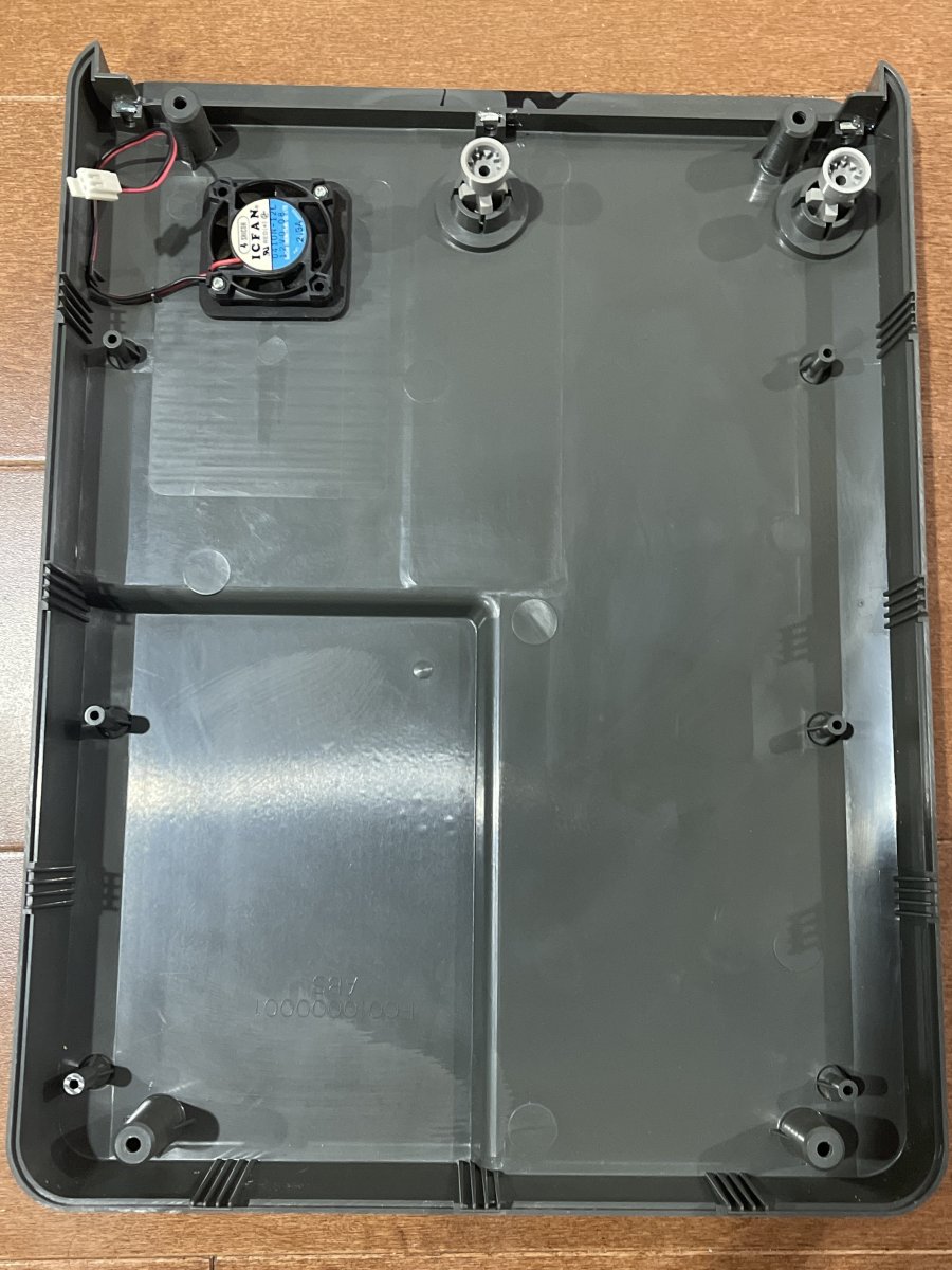

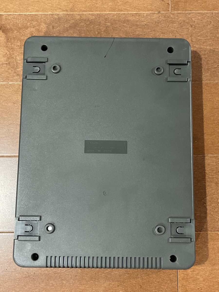

Boards are super clean. Case is a little dirty. Not cracked or damaged. Fan is pooched. Will need new fan.
Cased back up.
Cleaned fan it’s better than I thought.

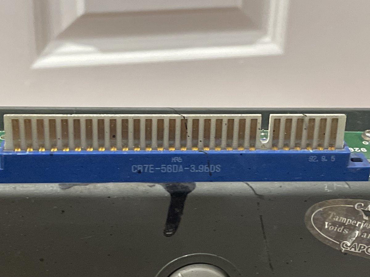

The black lines are not cracks, the best I can explain is it looks like an ink pen exploded and left marks.
I polished the card edge also.

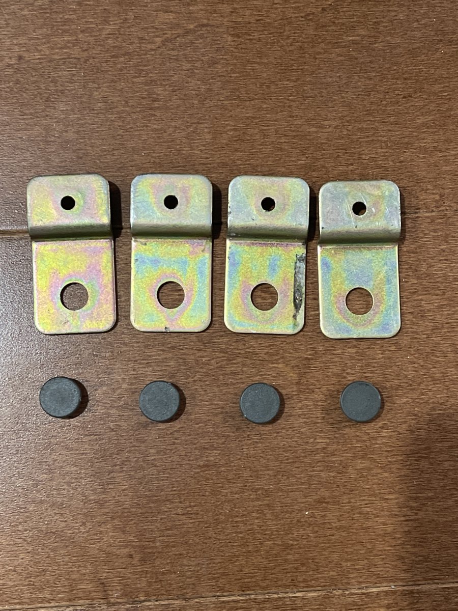

Comes with plastic caps ready to be glued back in and all 4 metal feet. Removed so they don’t get snapped in transport.

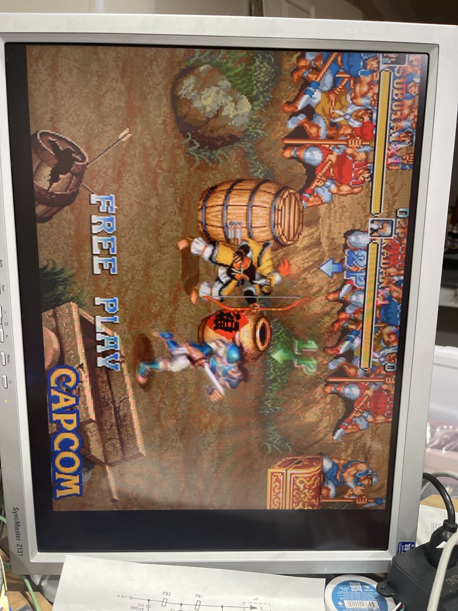

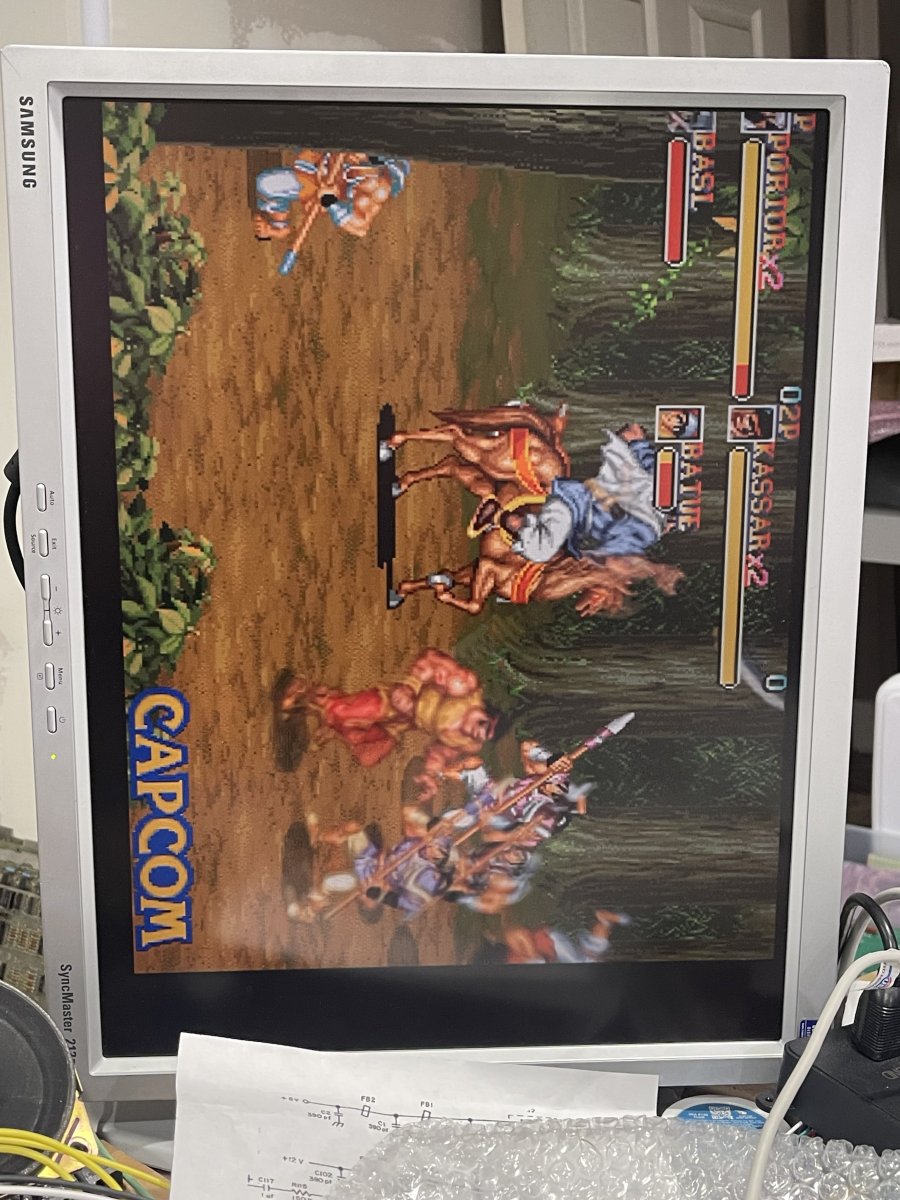

This game is ready for its next home with a long life ahead of itself.
Cased back up.
