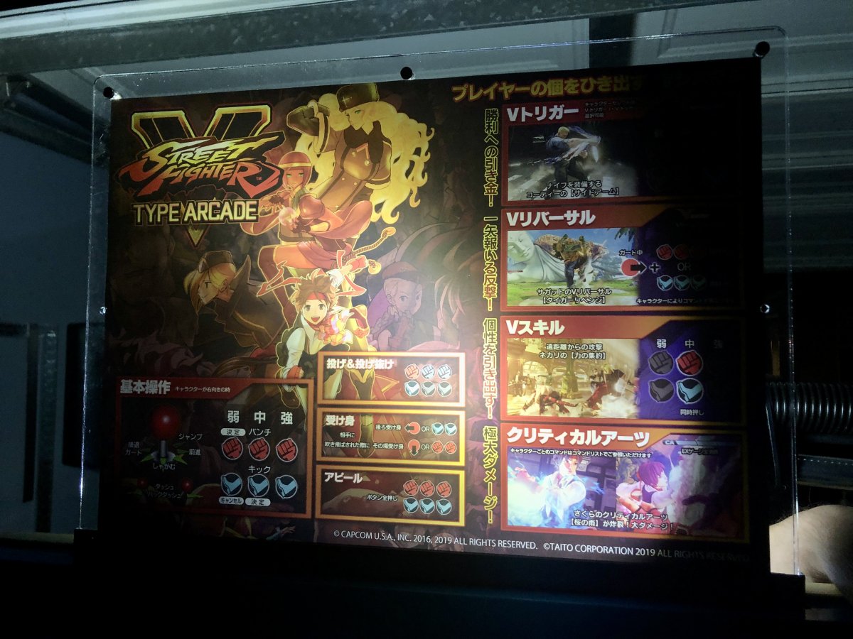

I've never been able to find any official images in my manuals...
But I believe the thick plexi part of the marquee should face forward, while the thinner cover should be behind/on the back.
The reason being, its the plexi itself that glows/illuminates, not the thinner cover (as this is only clear plastic).
You want to see the art work you've installed, not a silhouette because its being light from behind (ie thick plexi behind art work).
Thoughts?
Or better yet, confirmation with a manual image depicting marquee art installation?

Official Vewlix marquees backlight just fine. This is a flashlight to demo on my personal plain acrylic repro (that you can see doesn't have the middle holes cut right, something to fix next time I redo it).

I presumed the same, but it does appear the manual (for the FC at least) illustrates the opposite--i.e., the thick Plexi behind the artwork rather than in front. Here's the relevant portion:

The Naomi Universal marquee works on the same idea. The marquee is edge lit and the plastic back piece glows. All of the original Naomi marquee artwork is printed on backlit film. I wonder if there ever was any official Vewlix artwork that was like that?
