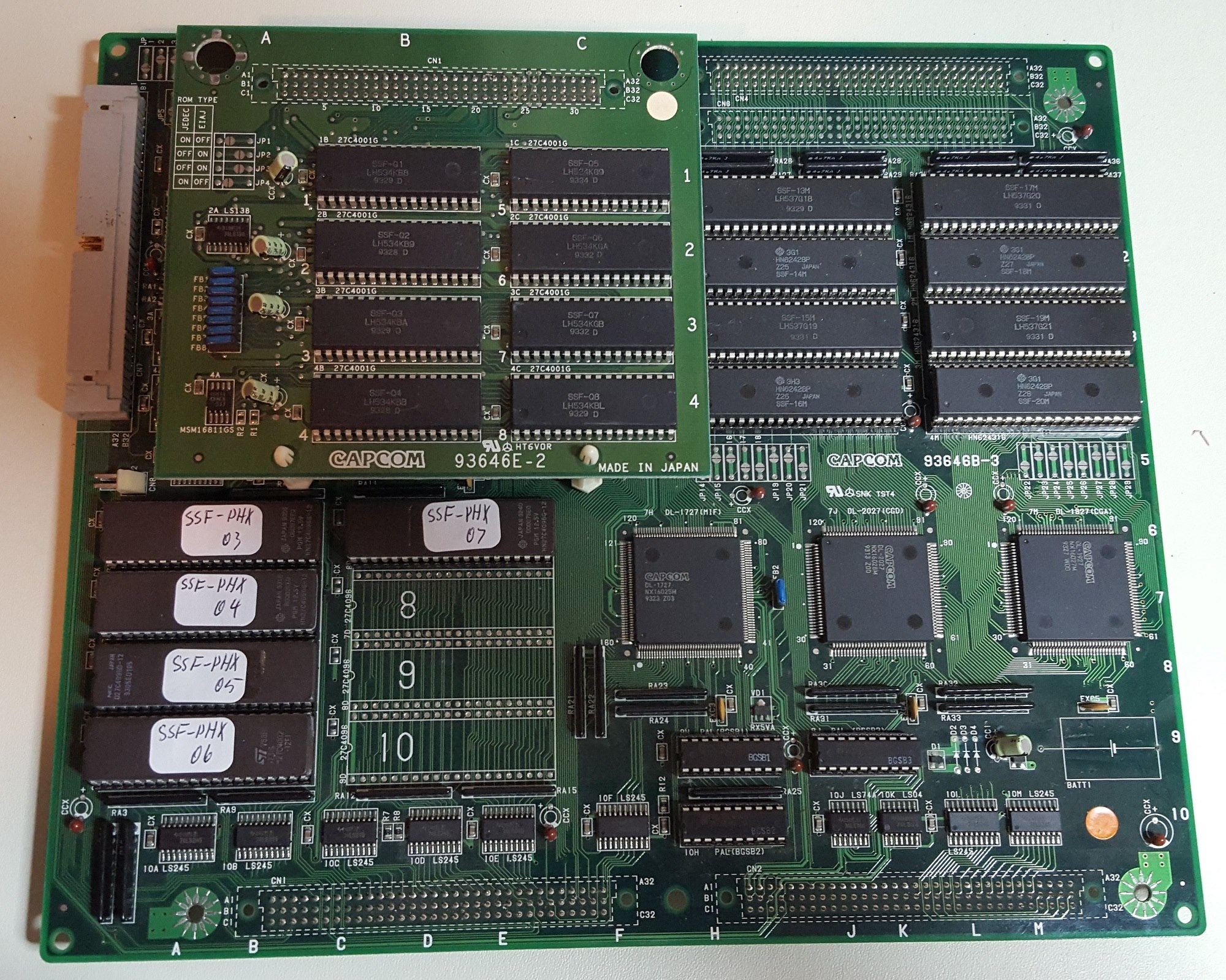

Just an FYI for everyone... Some B boards don't come with CN6 header. I had to install the header and even after doing so still get graphical errors. All solder points have been checked with meter for continuity and good. I'm not sure if its this B board not being compatible or if its the Darksoft pcb being defective and in the process of getting a new B board to try the kit on. Will keep everyone posted through my testing.

So I managed to get another B board to try the kit and everything works perfect. Users beware of boards without the needed socket.
I've only seen a few B-boards, but they all had the CN6 connector... So I suspect this is a little rare.
What I have noticed (and infact my board suffers from) is the missing connector for the network/tournament board. This seems like 50/50 so much more common/likely.

Just looked at my SSF2 and it does not have a CN6 header. 93646B-3.
Same here. I'm finally getting around to installing this and just ran into this problem myself. So the only option is to install the connector, I take it? Has anyone done this successfully or were there any other issues present after that (besides the graphical issues mentioned earlier)? Anyone have these connectors on hand or know a good place to pick one up?

I don't suppose anyone has had any luck modding one of these versions of the board or otherwise gotten the multi to work successfully on one, have they? ;)
