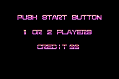

I think the root problem is that both of these games go to the static title screen once a coin has been entered while they wait for someone to push start. And then for freeplay the developers simply forced the internal credit value to a positive number. The result is that Attract mode never runs and it sits on the title screen waiting for a player to push Start.

I don't think burn-in is a concern in home use. It takes thousands of hours before a static image turns to visible burn in (naturally monitor brightness has some effect).
I put roughly 5000 hours into my F-Zero cabinet with free play turned on. I swapped the monitor just recently and theres no sign of the free play text on a white background on the old monitor.
Anyway, first Turtles is the same. It just sits on a static screen.

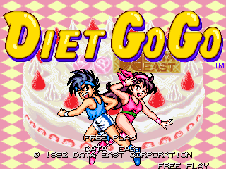

I think I remember Diet Go Go also doing this.
I'm making a list, see below.

This is the big reason. Diet Go Go got very little play time, probably because you have no idea what kind of game it is if it just sits on a screen that looks like this:
At least Turtles is a known entity.
