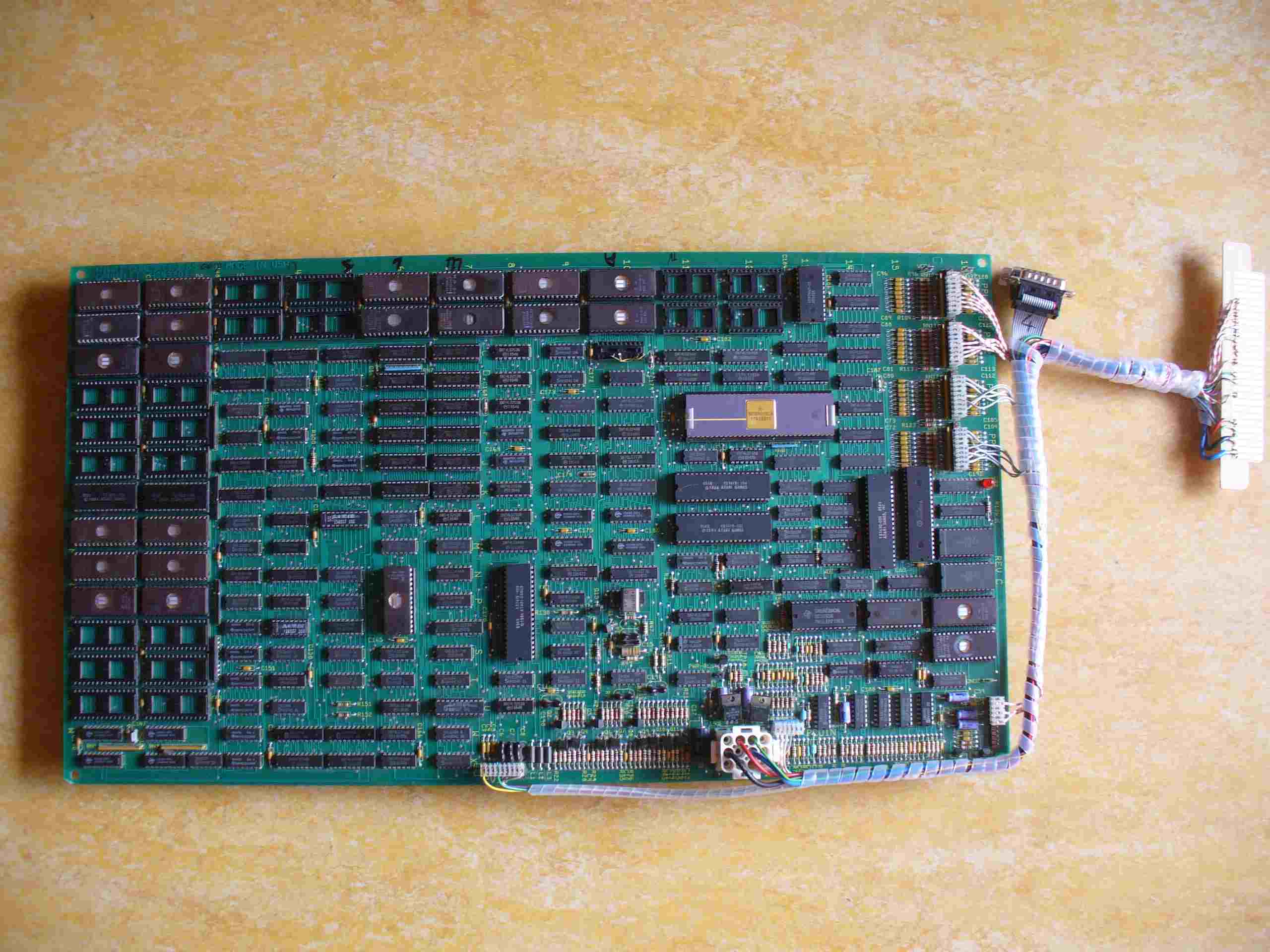

you can do that yourself. it's not too difficult at all.
I built it myself a few years ago..........

no need for 15V +/-
you just have to note that the sound is not amplified on jamma pin 10 & L (stereo)
Does anyone here make them or know where I can score one that would safely work via supergun route.
you can do that yourself. it's not too difficult at all.I built it myself a few years ago..........
Wow, kudos for this, and how clean it came out! I bet you could sell these! Hell, I don't own a Gauntlet, but I'd buy one in case I ever did!
i see the slapstic chip is bypassed,
so it's a conversion - owner needs to put some damned stickers on the eproms!
yes,
it is converted to another version, but I have the original slapstick & romset.
of course I know the discussions about the eprom stickers too.
however, never had a problem without them...........

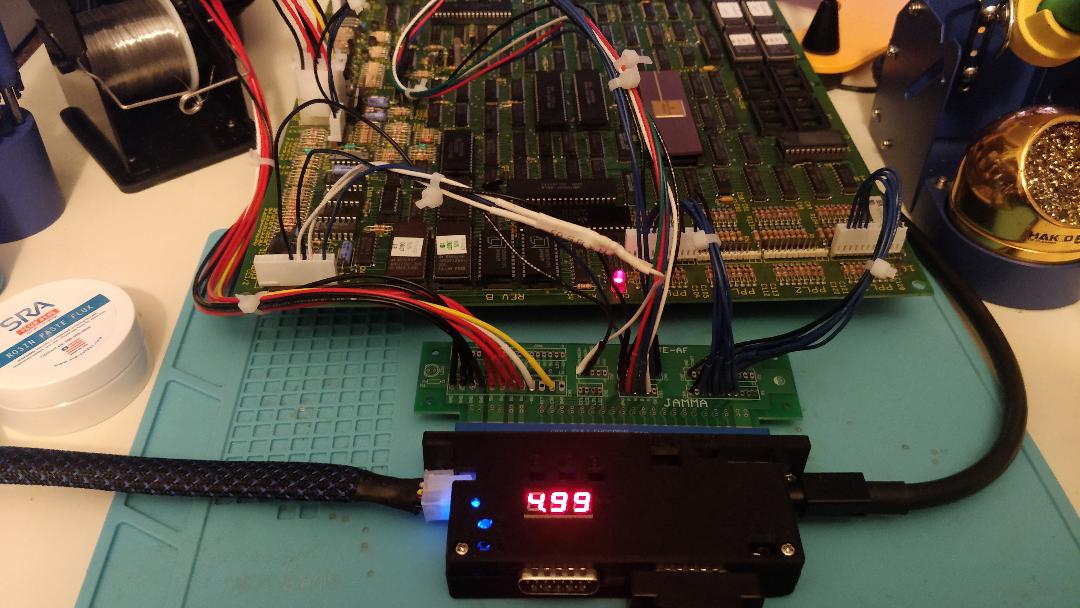

Decided to give this a try and am quite pleased with the results. I made my first JAMMA adapter and didn't royally screw anything up. I was very happy when I heard "Treasure 100 points"!
Definitely need to work on the cable management @Astro X but thanks for the pic got me motivated enough to try this little project out. 8o
