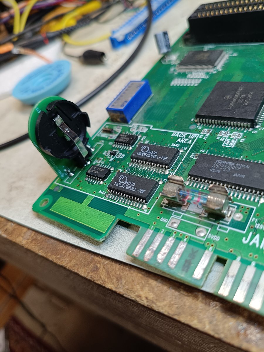

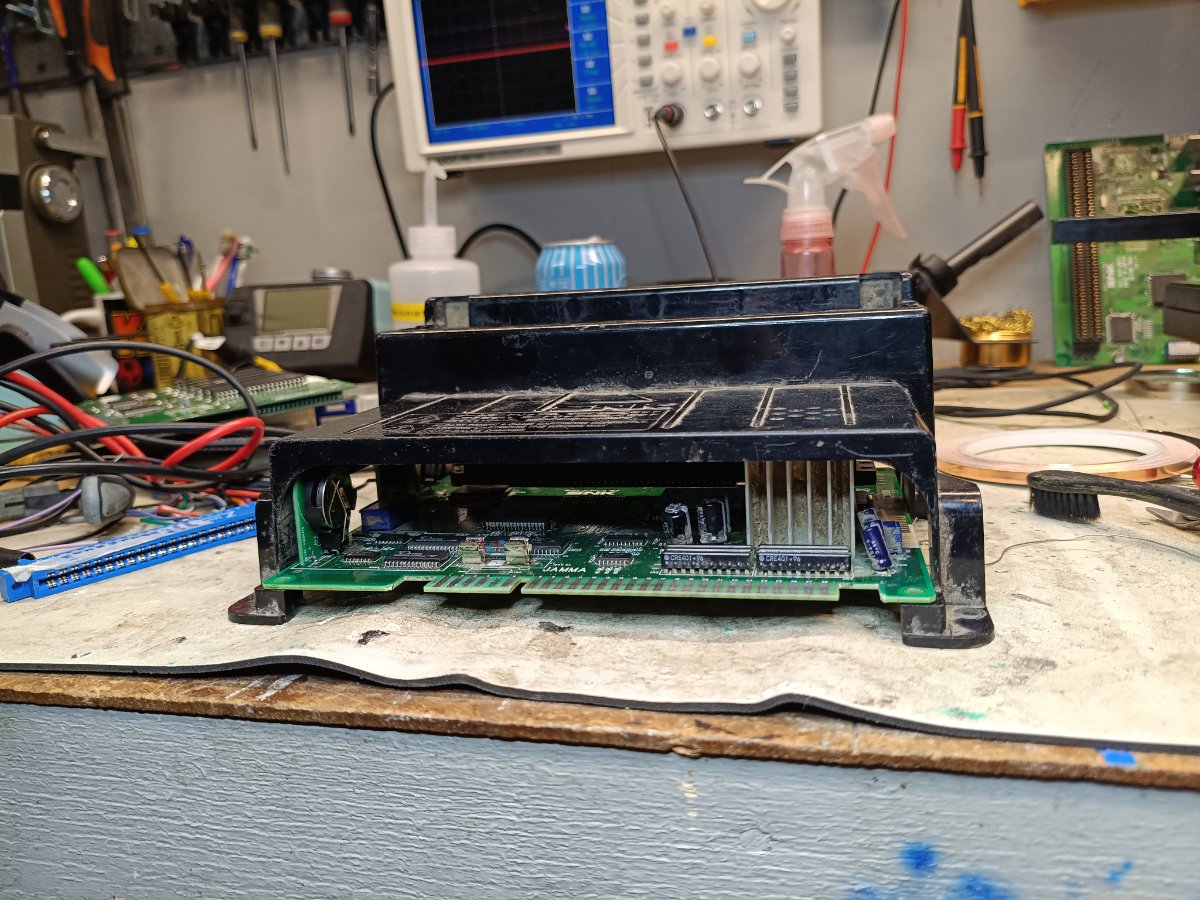

Simple board that some of you may like. It is to be used with a 19 mm coin cell battery holder and a 2032 battery on a board with disabled charge circuit. (Original battery is a Toshiba VG2430 rechargeable 3V lithium battery).
Note: I've used the horizontal version in my projects. But here is an updated (smaller pcb) one. Vertical is completely untested (use angled pins). As always when you get something for free; I don't take any responsibility what so ever. These boards may kill you. Or destroy your MVS-board. They may also work on MV1C-boards. Please report back if you try.
