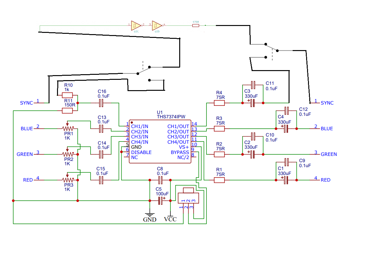

Hello everyone,
I'm using a CXA1645-based encoder to convert the output of my minigun to my tv. It requires a TTL sync while the RGB signals are 75ohm. Right now, I just have a jumper wire coming out from the jamma harness itself to get the sync from but I'd really like to make a cleaner setup and have switchable sync levels coming through the mini din connector. I've taken a part of the design from the picogun that outputs ttl sync with a 74hc14 buffer and used a DPDT switch to toggle between them. This is what I had envisioned. Excuse my use of MS paint to draw the schematic. Will this work? Are there any issues with this design? I'll have to cut some traces and tack a 74hc14 and switch onto the bottom of it, but it's much better than having a wire coming straight from the harness.

Huh? The THS7374 assumes that the sync level is at TTL and so do all superguns. Why would we need to strip it then combine it again just to be sure it is at a TTL level?
if you use the stripper you do not need the combiner. if you use the combiner you need to have H and V sync available in order to combine them.
i dont know if the ths assumes TTL, it doesnt care what sync or signal with sync in it which you throw at it eg (Y, CVBS, sync-on-green or TTL).
all i was saying is, if you give a sync stripper any sync signal in (almost) any condition it will output TTL sync for you.

Ahh ok gotcha. But in most cases, and considering that the picogun uses the 74hc14 buffer for it's TTL sync buffer, I feel like the boards that have wonky video are very rare and probably not something I'm going to be playing with anyways. Shouldn't the solution in my OP be serviceable with most boards?
I'd also really like to use my existing part supply rather than ordering more stuff from digikey heh. I already have everything to modify my minigun into the design above.

Could I use an LM1881 in a design like this?
https://www.retrorgb.com/syncstripperchiponly.html
So instead of the dual 74hc14 schmidt triggers, you just put this in place of it and still have the DPDT switch in place? Would the switching of inputs/outputs cause any issues?
