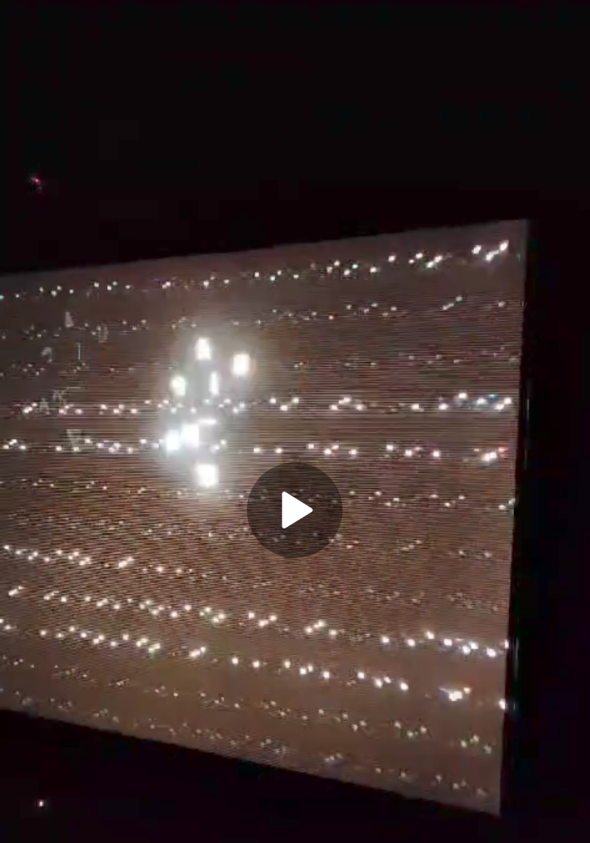

Golden Axe I have graphic problems, reprogrammed and verified all C roms, its like jailbars on screen, (I forgot to record a video)....

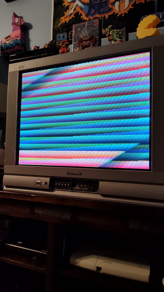

*** Golden Axe and Shinobi both display the colorful checkerboard like when no bios is loaded
*** Tested on multiple MV1B motherboards
I'm using identical donors for both carts (Super Sidekicks 2).
*** Both donor carts worked well before conversion.
*** The below information is from my testing on MV1C.
Golden Axe just goes straight to the crosshatch.
One time (only once), I got a garbled NEOGEO on the unibios screen, followed by the silent Neo Geo splash (normal). There was some slight garbage in the splash. a little rectangle that didn't belong.
When the attract mode tried to start I got the crosshatch.

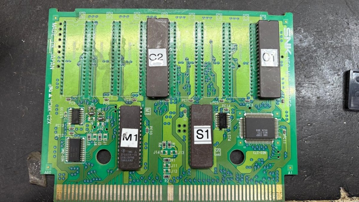

V1 pin 28 ring came off while I was removing the original ROMS. I expose the copper on the trace and patched a small piece of wire from the pin to the newly exposed trace.
I have the same thing happen to a pin on V1 on Shinobi and patched the same way. It came out better on Shinobi but it's not as bad as the image appears.
Any thoughts?
