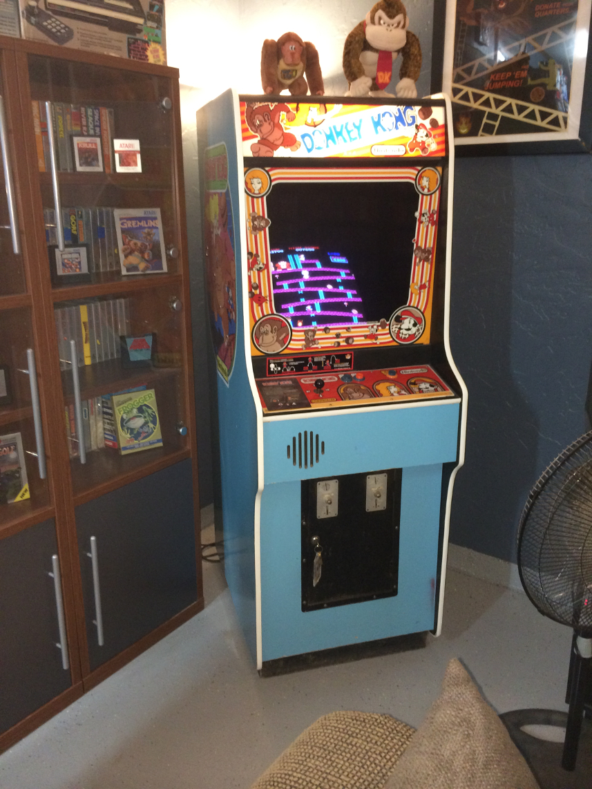

While I was at this guy's place, turns out he was quite the game connoisseur. He goes by lord_sega_ on Instagram. His collection was stunning and he let me take some pictures:

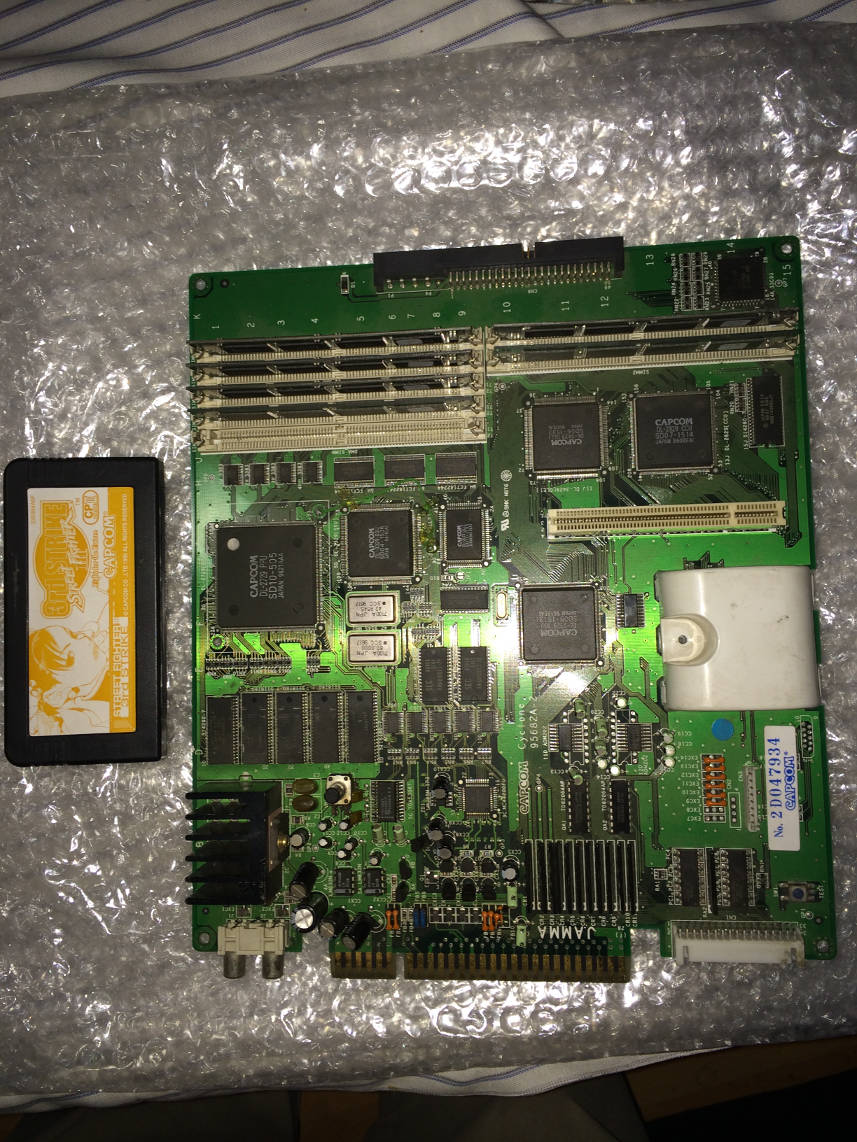

As fate would have it, I picked up a repro CP from @Derick2k and it arrived the same day! I had designs on using that CP to convert the Sega Die Hard arcade cabinet into a Candy Cab, but now I have a better purpose for it and can use this plain CP for that purpose anyway. Also, on Monday of this week, a friend I made in my arcade travels through Craigslist traded my CPS3 case/cage for his dead CPS3 board. That came complete with enough SIMM's to play 3rd Strike!
