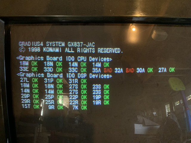

My beloved Gradius IV was working fine until the weather changed last spring. And now it wont boot up.
On the Checksum it gives the error: 35A BAD!, 32A BAD!

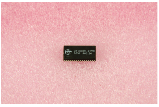

After Taking the Top PCB off,
I tracked down 35A and 32A which were Cypress Semiconductors listed as SRAM.
I googled the Cyprus Semiconductors and found the right voltage but it doesn't say 9721 595831 and arent listed as 1M (128k instead)
