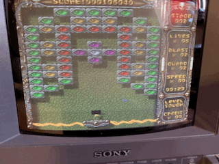

I've got a weird problem on my MV1B that I've noticed with the homebrew title Hypernoid, part of the ball sprite is corrupted like this:

Anyone have any other ideas? I'm in touch with the developer and they are unable to reproduce it on an MV1B which makes me think I have a subtle hardware fault somewhere...
Being able to see a bigger version of the image would help or even a video of how the corruption changes as the ball moves.

Here's a video:
View: https://youtu.be/qfJUyh6V2uA
I'm running the game from a NeoSD, I've tried putting it in different flash slots and it still happens so I think that's ruled out.
It only seems to happen in the lower section of the screen. It definitely gets worse the longer the machine has been on for, if I power up from cold it's fine, but leave it in attract for 20-30 minutes and it'll start acting up. However if I immediately boot into a different game, no obvious corruption.

I agree if the game did this from the get-go then it would point to either a fault of the game, or firmware on the flashcart, etc. however because it seems to be a function of how long the MVS has been powered on (rather than just the game itself, I can warm up the MVS with a different game and then switch to Hypernoid and I immediately see the fault) then it suggests to me that some component somewhere, either in the MVS or possibly the flashcart, is on the fritz rather than a bug in the game.

I think I eventually got to the bottom of this. I ended up replacing one of the two VRAM chips: https://www.arcade-projects.com/threads/mv1b-vram-issue.33583/
This seems to have cleared up the corruption; I've left the game on for a good while and it's not reoccurred. I'm amazed I didn't see it in other games but then it was so sporadic maybe I was just (un)lucky.
So nothing to do with the game/flash cart.
