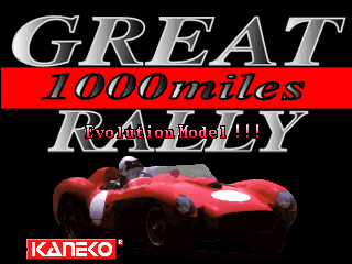

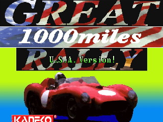

I just found out there's an updated version to Great 1000 Miles Rally subtitled 'Evolution Model!!!'. It has two additional cars, some new graphics and samples. There's also an 'U.S.A. Version!'. How this version is different from Evolution, I don't know. The programs roms share very little between the two. Both versions are dated like four months after the first release (which I have).
There's six roms that are different to vanilla:
2x main program roms (gmmu1.bin, gmmu2.bin)
A rom that holds MCU data (mcu_code.u12)
2x sprite roms (gmmu64.bin, gmmu64.bin)
and an additional rom that holds samples (gmmu24.bin)

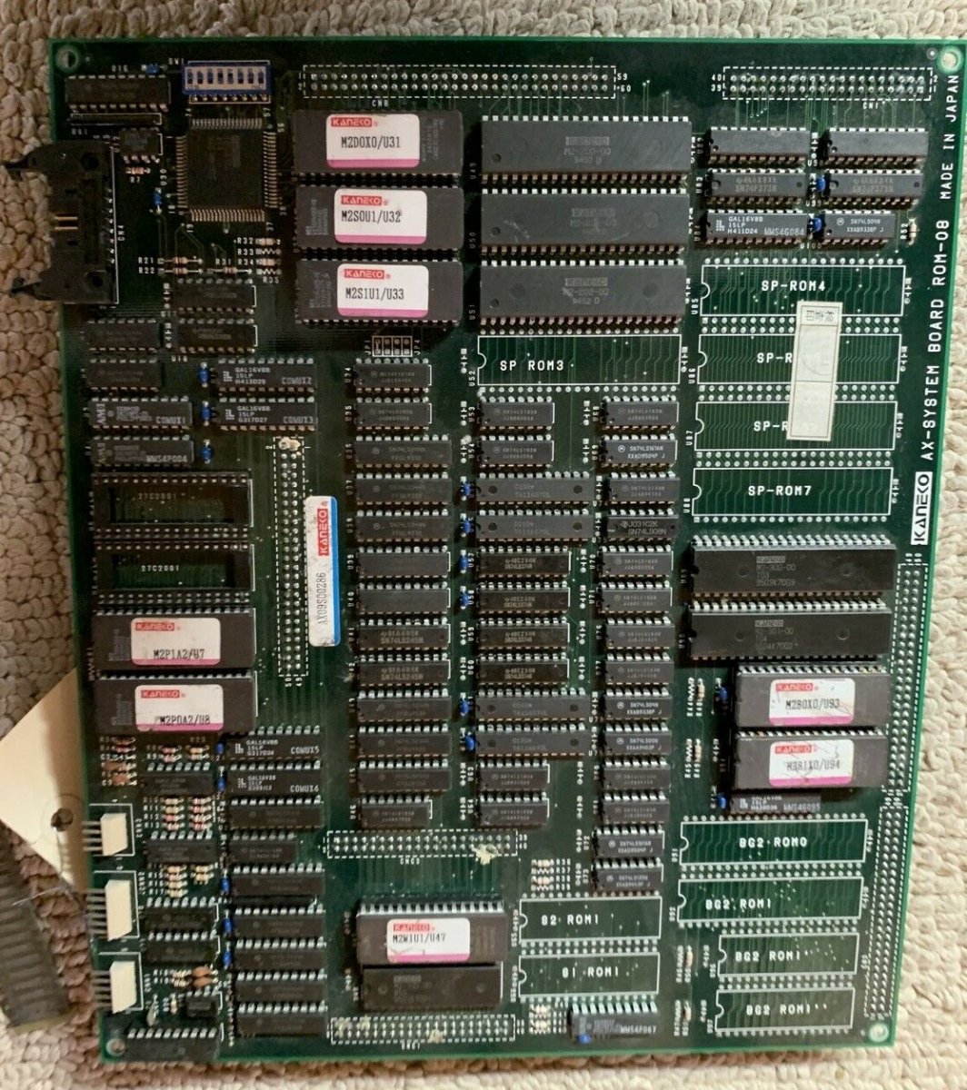

I burned the roms and placed them where they would logically go, but the game gets stuck on test 5 on boot.
Anyone else try it?
