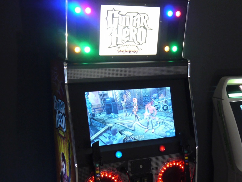

Just wanted to say a BIG THANKS to Nem!
I had the same issue - broken marquee and reading this forum helped me heaps.
I did the same as him but I put in some colour changing LED lights. Looks great!
Thank you Nem!
