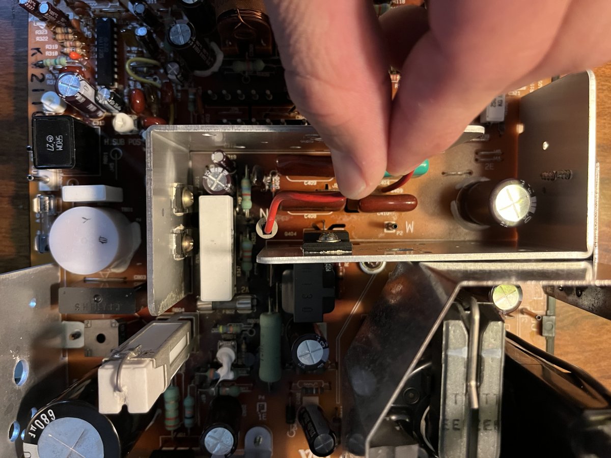

Just wanted to give a general thanks to the monitor forum. Have a backup Sanwa 1723D for my Cute and the pic is to wide. Recapped and it got better, ferrite core stuck in coil, soaked it and got it to turn. Not enough adjustment, after reading hundreds of posts discovered a ‘N’ and ‘W’ jumper exist. Mine was on W, set to N and picture is perfect. Thanks.
