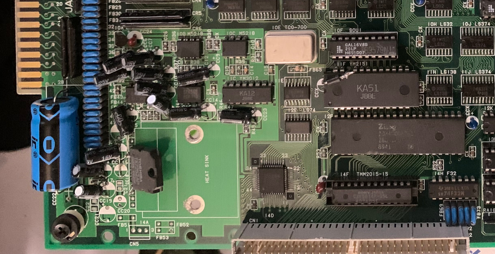

Looks to be a rescued CPS 1.5 A-board. Swooped up from a Chinese source, intending one to be used for the multi. Surprisingly, it works. But I want to restore it to its former glory:
  • YM2151 has to be replaced
  • Needs a recap
  • HA13001 will need to be replaced
All these are easily sourced, but the heat sink. Might have a couple of dead A-boards I can pull this from, but anyone know of a suitable replacement that can be sourced from the internet?
I was thinking something more like this:
But no matter, I think I have at least 2 dead A-Boards that I can pillage. Will go with that.
