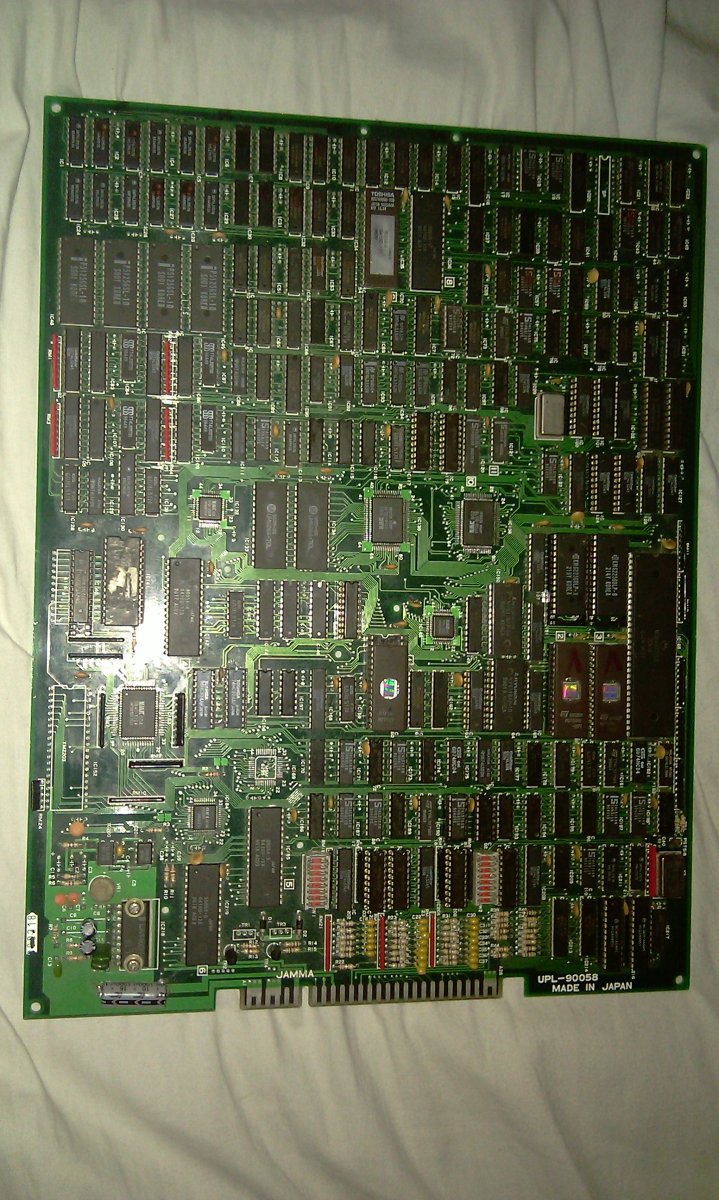

Aside from that we used SL dips for rams, 16bit roms and other similar tricks where possible to get the size / part count down.
At the end of the day the size should be about the same as the mustang original it was mostly based from.
Thanks @Snax Tan for this pcb :thumbsup: (sadly the nmk004 is dead on this one :( ).
