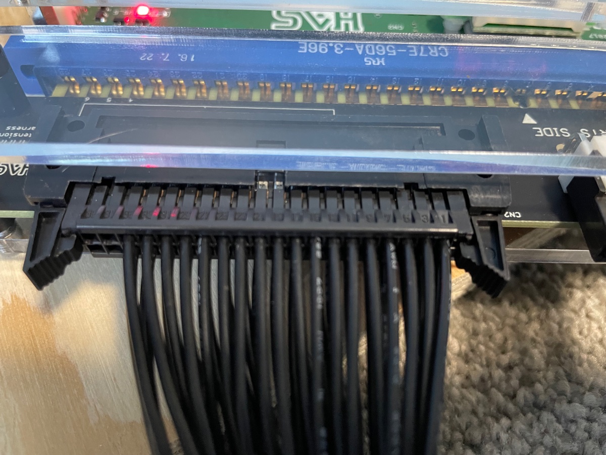

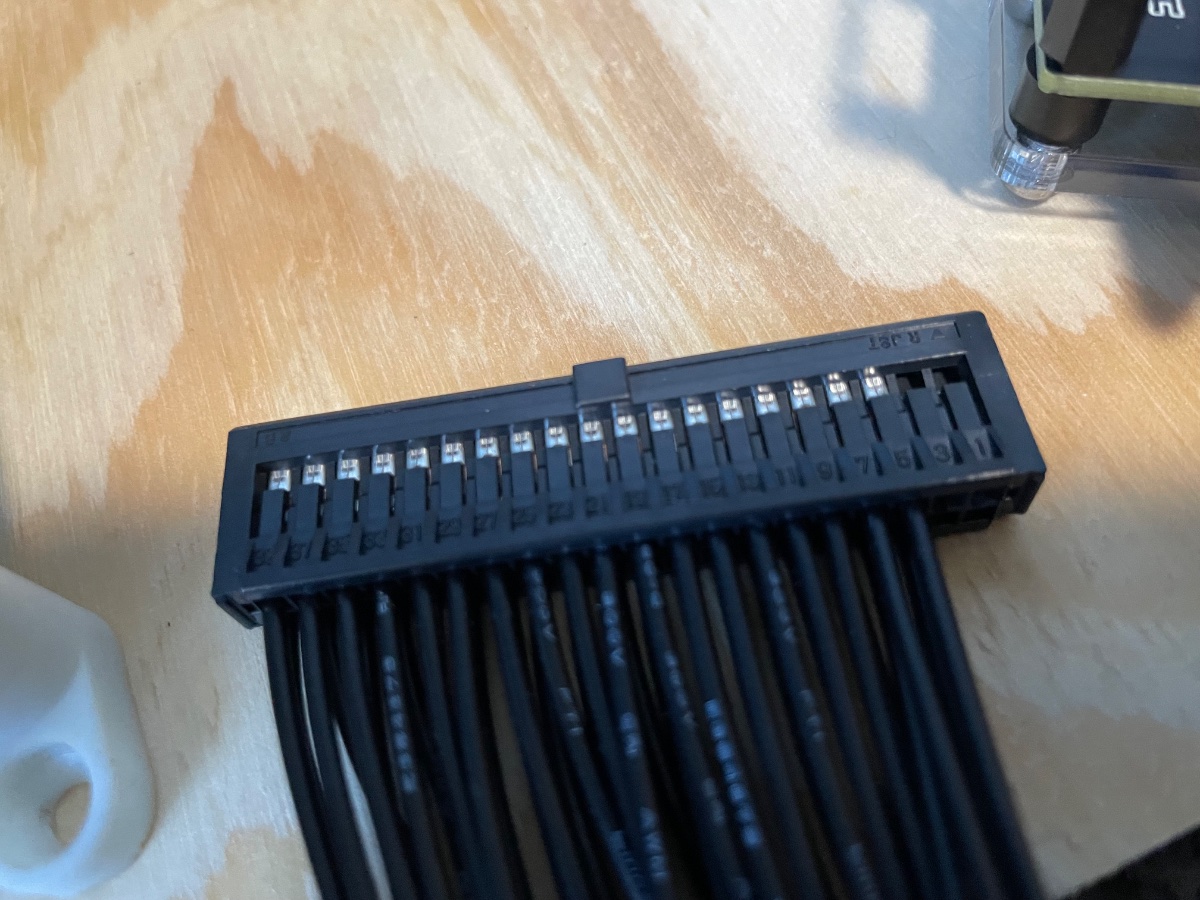

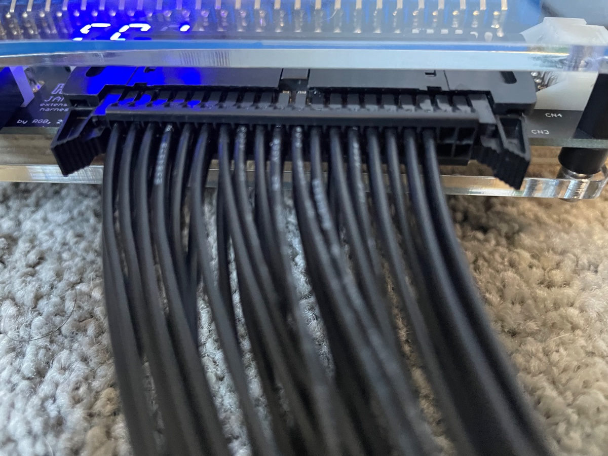

Please don't cut anything, this isn't necessary for the HAS. Can you post a picture of the harness end that connects to the PCB game? I want to see how the signal harness is oriented (it uses a 40-pin connector, but 4 pins aren't populated).
Ok, here are some pictures. The 40 pin connector is keyed so it really only goes in way.
1) Jamma end
2) HAS end
3) Jamma end

Thank you for the pictures. Rotate the signal harness 180 degrees, and everything will work. The harness SHOULD have a white/golden mark on one end - it should face the PCB game (the same goes for the power harness).
