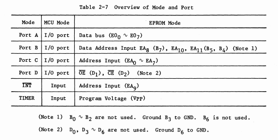

stj Grand Master Joined May 4, 2017 Messages 1,721 Reaction score 893 Location England Feb 10, 2021 #1 has anybody tried dumping a 6305 with a 4k maskrom as a 63705 eprom based device?
A Apocalypse Feb 11, 2021 #2 I've dumped (and programmed the UVPROM based ones) those MCUs before using an adapter to 27C256. [EDIT] Last edited by a moderator: Feb 11, 2021
stj Grand Master Joined May 4, 2017 Messages 1,721 Reaction score 893 Location England Feb 11, 2021 #3 i did that. i also included a 4MHz crystal & caps and the 2.2uf reset cap mentioned in the datasheets. did your adapter have power-on-reset or a clock? it's unclear if they are needed in eprom-mode.
A Apocalypse Feb 11, 2021 #4 My adapter contains only wires, with connections made as per table above. [EDIT] IIRC in read mode Vpp must be tied to Vcc. Last edited by a moderator: Feb 11, 2021
stj Grand Master Joined May 4, 2017 Messages 1,721 Reaction score 893 Location England Feb 11, 2021 #5 i will look into this.
