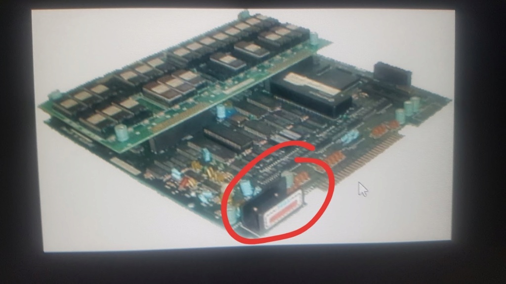

Hello
I have one 16B working perfectly but missing heat disspator for sound amp, where can I buy one from 16B or a disspator compatible.

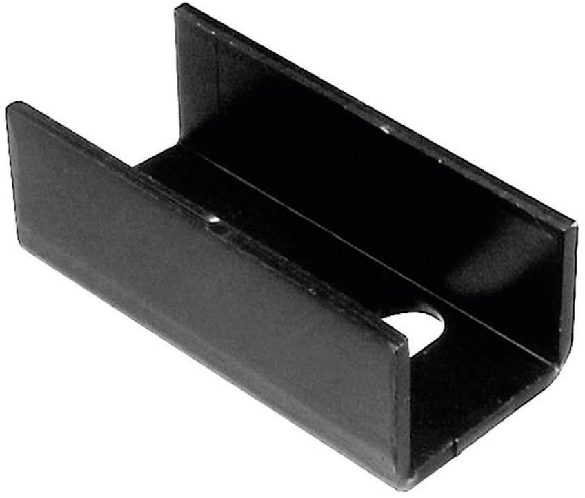

Finally I bought this one:
it's smaller than original but sufficent for the amp. For fix the amp I will use self-tapping screw and Thermal Grizzly Thermopad.
What' do you think about that?
most bootleg boards dont have a heatsink and seem to get away with it,
so it should be fine.
but dont self-tap,
if you have a tap & die set then thread it for M3, otherwise use M3 screws with washers and nuts.
