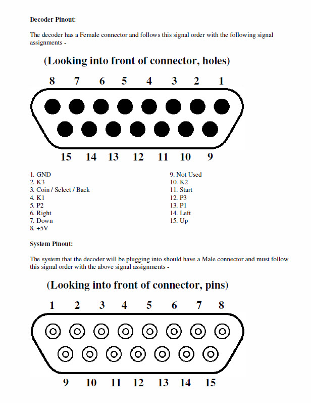

I have my Naomi 1 connected to capcom IO that is connected to a Delux SMallcab supergun. USB DEcoder is connected to player 1 DB15 port of the supergun and Kick Harness from Capcom IO to the supergun DB9 port made for it.
I tried with many usb fightsticks and all have the same issue .. Kick button 5 maps to Select or Back and Button 6 seems shorted as it shows its always active "1". The minute i unplug kick harness its gone.

What usb decoder are you using?
and does it work with the superguns db15 pinout

Hi im using the undamned-usb-decoder got them from Paradise Arcade shop .. not sure the pinout they use but they work fine one some other supergun with a Naomi and a sega IO.

I think the DB15 port on the supergun doest not work with the UD decoder,
