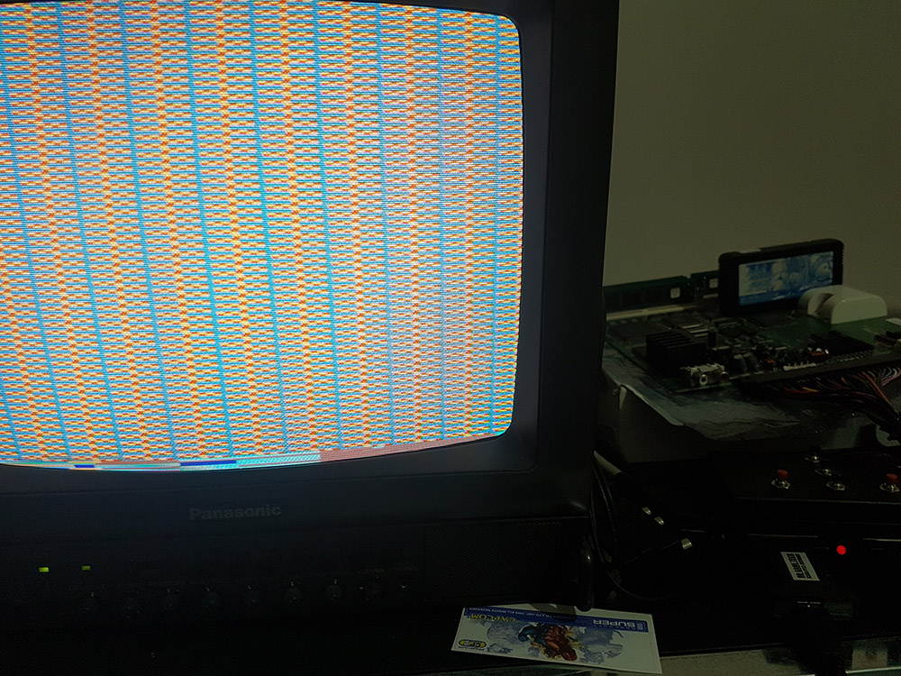

So, with all simms installed and DS multi cart i get this first screen.

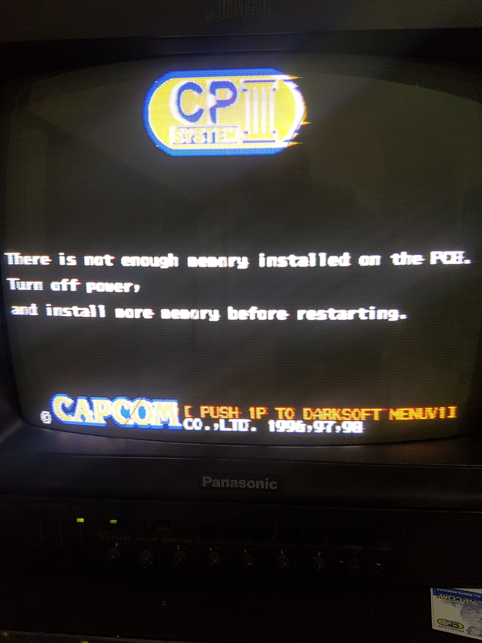

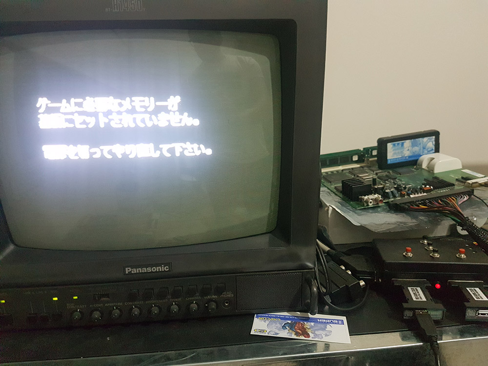

Also with all simms installed and Sf Ng cart i get this message, does anyone knows what it say?
Any suggestions? Might be simms problem right?
Thanks in advance !
First screen tells me the darksoft cart is probably dirty or you need to reinsert it a few times.
Second screen is a memory error. If you can get the darksoft cart working you can see which simm is bad. ;)
Yeah @Mitsurugi-w you were right, moved it several times, now im on this screen, however cannot enter menu, now im getting invalid cd. I´ll get back when i figure whats going on, has to be related with scsi2sd iso image. Thanks!

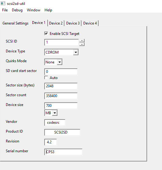

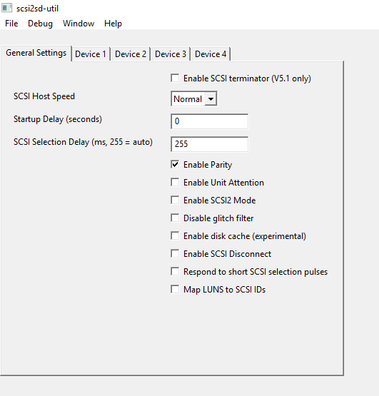

I´m having trouble making this work.
Have followed instructions in scsi2sd posts.
My status is, "you have inserted a new cd rom etc" and then "invalid cd rom"
I downloaded the image from the darksoft post, custom version. Mitsurugi sent with my modded cart the cd version, i guess its the same as this right? Cause i dont have in hand a cdrom drive to see.
http://www.mediafire.com/file/p8eieg5zz47rmk6/UniCD-CPS3_for_custom_SH2_V5.7z
In case i have done everything ok, i can think of:
- bad cscsi cable
- something still related to bad simms ( im following mitsu advice on running the ds multi so i can verify wich simm is bad but encounter this invalid cd rom problem first.
