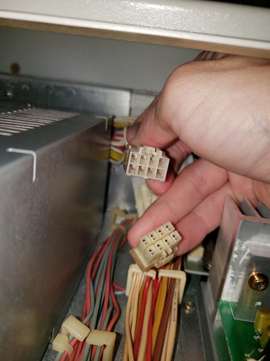

Does anyone happen to know what the small female connector is that is coming out of a Sun Power Supply?
I'm looking to make a y-splitter, but am having a hard time finding the exact TE AMP female connector, male connector, and pins I would need.
Picture attached below.
Thanks in advance for any help you can give!

https://wiki.arcadeotaku.com/w/AMP_Universal_Power
8-pin male connector (white), 176275-1 (https://www.te.com/usa-en/product-176275-1.html)
8-pin female connector (white), 176286-1 (https://www.te.com/usa-en/product-176286-1.html)
Female pin for male housing (AWG#20-16), 175152-1 (https://www.te.com/usa-en/product-175152-1.html)
Female pin for male housing (AWG#26-22), 175151-1 (https://www.te.com/usa-en/product-175151-1.html)
Male pin for female housing (AWG#20-16), 175150-1 (https://www.te.com/usa-en/product-175150-1.html)
Male pin for female housing (AWG#26-22), 175149-1 (https://www.te.com/usa-en/product-175149-1.html)
Thanks, nem. I'd been trying to find it based on that wiki, but was definitely off. Glad I asked.
