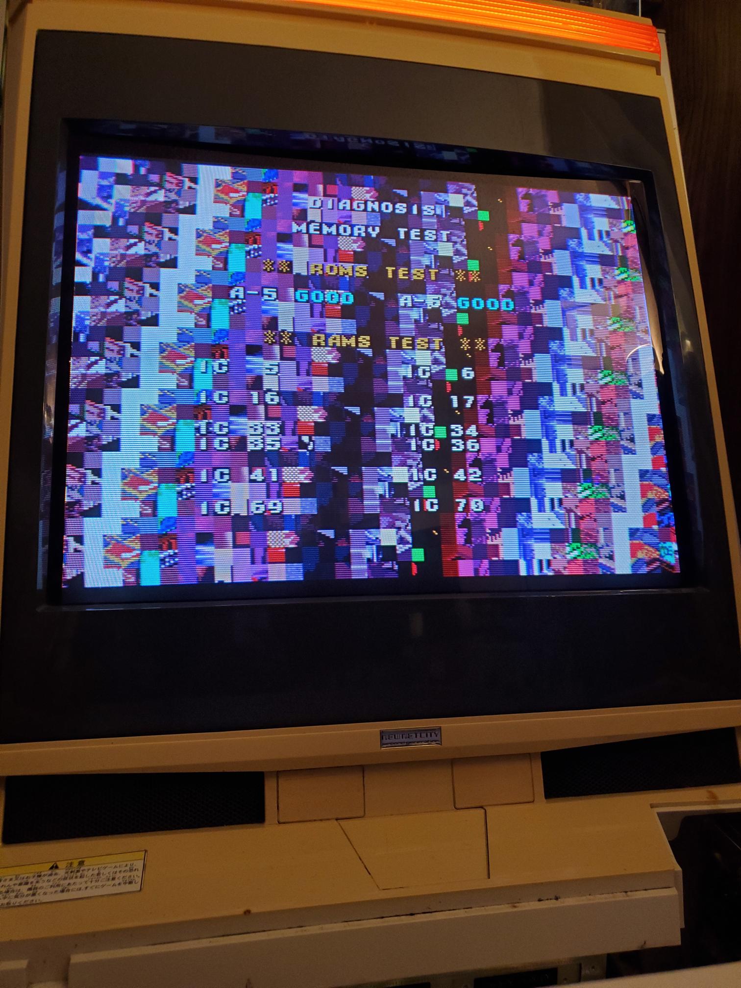

anybody can help? Just got my moonwalker in the mail a day ago first cap was messed up from shipping replaced them all. When I do a ram check that happens after the first check.

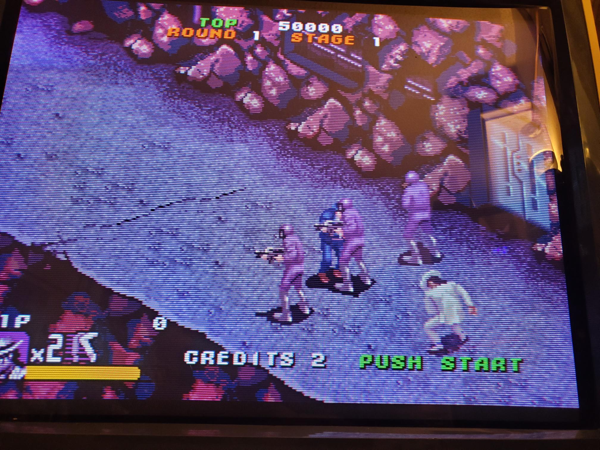

3rd when I finally get Into the game it freezes either goes black or when I shoot Micheal freezes and that's it. Once I get hit by a person they do animations but nothing else.

The ram test is visually aggressive but that’s what it does normally. Try it in mame!

What's your +12 reading? The fact that it's freezing, resetting or giving a black screen is suggesting not enough power to me....
