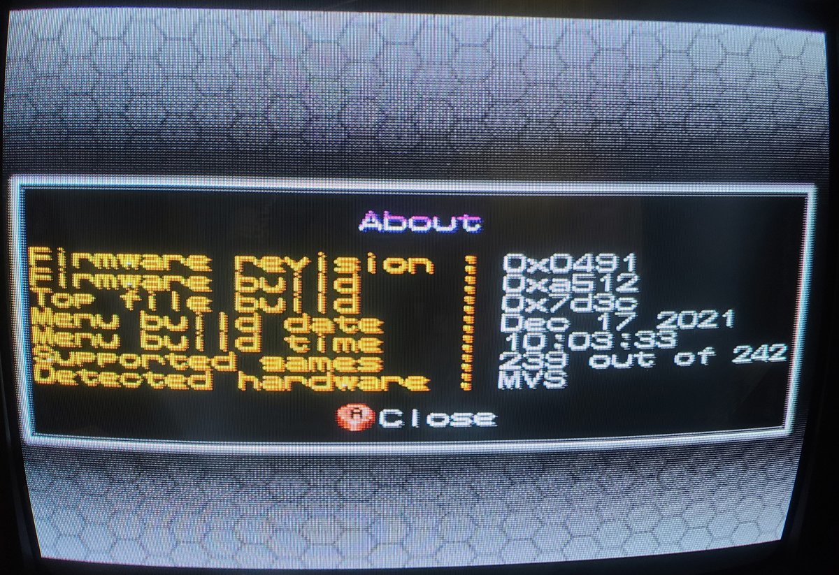

So I was having issues with a few games (MS1 hitting the exception error handling screen like below after selecting cheats, sound issues in a couple of games etc.)
Realized my menu wasn't running the latest version so I updated that and was still having issues. Here's a pic of the cart status the last time it worked:
