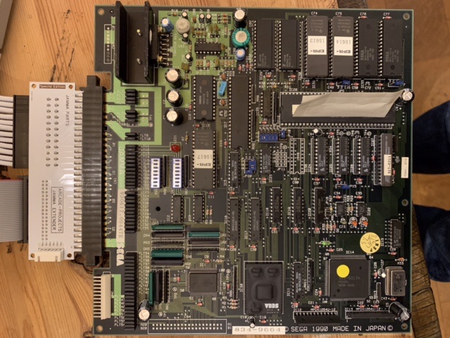

i received a a system c2 board (tant-r) yesterday, but when i connected it to my has or my blast city, it starts in attract mode,but it doesn‘t react to my coining up.
When i try to change the dip settings to free play it still shows insert coin.
And when set the dip switch to sound during attract mode it stay silent.
any ideas what i could try? Otherwise i would need somebody who can repair this for me...
Thanks for your help!
