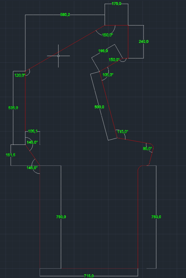

moflih.morad Student Joined Feb 18, 2021 Messages 53 Reaction score 106 Location Morocco Mar 29, 2025 #1 hi guys i would like to make a neo geo mvs cabs, but its seems that nothing is available on the interne, so i tried eye balling every corner from videos to pictures available can you help me please make sure of these measurements. thank you.... Attachments measures.png 72.9 KB · Views: 34

nauman Beginner Joined Mar 18, 2025 Messages 5 Reaction score 8 Location Sweden Apr 12, 2025 #2 There are measurements for a Neo Geo MVS-4-25 from Jakobud. Except from the marquee, everything else should give you a close enough feel. https://archive.org/details/Jakobud_Arcade_Cab_Plans https://jakobud.com/cabinetPlans.html Very unclear license so use wisely
